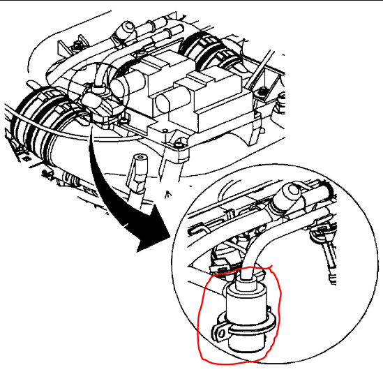

Where is fuel pressure regulator located on my 2000 Saturn LS2?

Hello again.
It is located next to the fuel rail assembly on the top of the engine. I've attached a picture below of its description and location .The regulator I circled in red.Hope this helps and thanks again for using 2CarPros.

Thanks. That does not look like the fuel pressure reg. that i remember for decades ago.

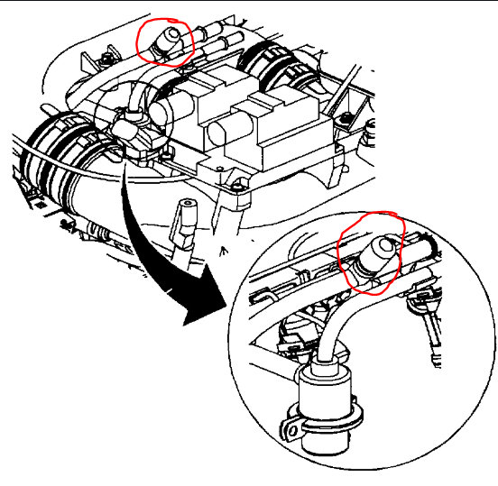

Hello again.
Yep, that's it. I've attached the same picture below and circled in red the schrader valve location where you attach a tester and test the fuel pressure.Hope this helps and thanks again for using 2CarPros.

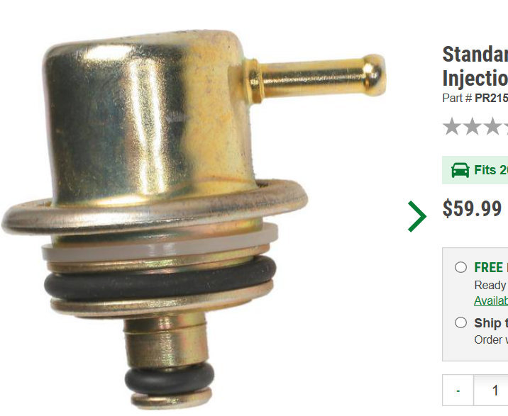

Danny,
It looks like there is a ring clamp going around the Fuel Pressure regulator. I thought there was a large tube like a fuel line coming off the regulator. I have always understood that if you you see wet fuel at the hose it meant the pressure regulator was bad. But I do not see a large enough rubber tube. I assume when you pull off the ring clamp the regulator will come out.

Hello Steve,
Yes, the regulator is held in place with a snap ring.You will need a pair of snap ring pliers to remove.After snap ring is removed you can pull out by hand.Be careful not to damage o-rings when installing to prevent leaks. I've attached a picture below from O'Reillys auto and they go for $60.00. Were you ever able to get a fuel pressure reading?Hope this helps and thanks again for using 2CarPros.

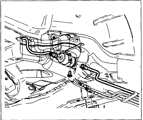

I am working on that issue now. I went to AutoZone and they have a loaner gauge as you thought and I will pick it up Monday morning and do the test. I downloaded the instructions. I think the Fuel Pressure Reg. will drop/come out the bottom of the housing, right? I cannot get to the vacuum tube, it is in a very tight space, don't want to use pliers. I am also replacing the fuel filter which may or may not help but won't hurt. What a mess, trying to save a buck, you know the drill.

Hello Steve.
You will have to use special quick coupler disconnect pliers to release the fuel lines from the fuel filter.They are available at all auto parts stores as well. I've attached the fuel filter location below.Keep me updated. And yes, I know the feeling of one step forward five steps back. Hope this helps and thanks again for using 2CarPros.

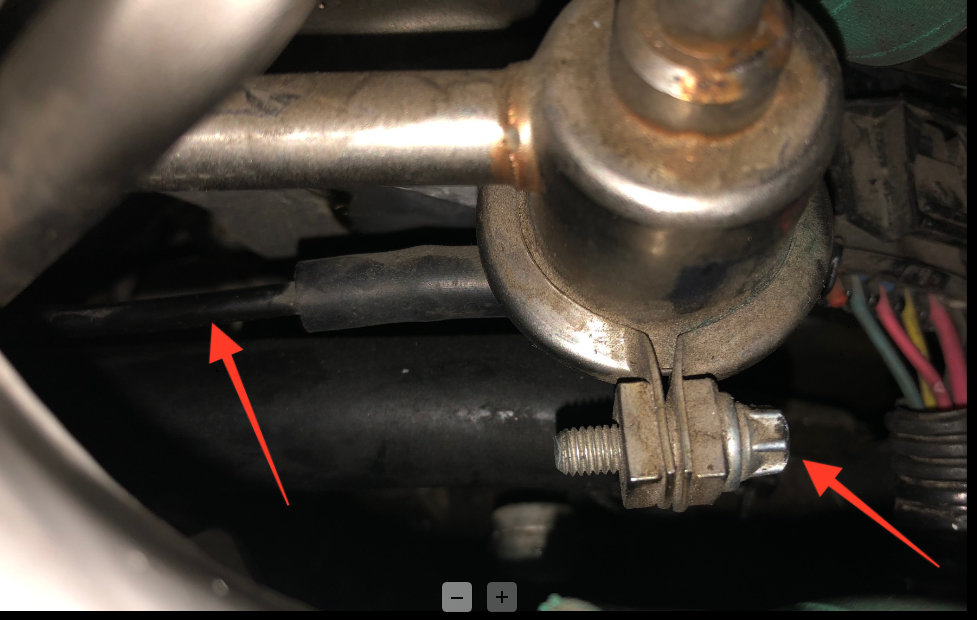

I took a snap shot of the Fuel pressure Reg. https://share.getcloudapp.com/OAuBEl5e
Notice: the Snap Ring isn't a normal snap ring but appears to be a Star bolt. Also the other arrow points to the vacuum hose (right) and that is the one that is in a tight space. Also if you can see it a tube fits into the rubber part and it is very small OD maybe is 1/8th inch. So it fits up into the casing.

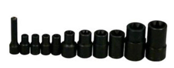

Hello Steve.
Yes, your picture provides more clarity than the one I did. Your regulator is held in place by a compression clamp. The socket you need for that is called an E-TORX. You can get those at any local auto parts,hardware,or home improvement store.I'm pretty sure you will have better ability to remove the vacuum line once you remove the regulator from the housing.Picture below.Keep me updated.Thanks again for using 2CarPros.
