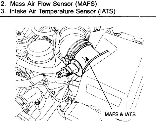

So the fuel pump will shut off if the PCM thinks the engine is not moving air into the intake manifold, I would unplug the MAF senor to see if everything starts working again. the PCM will install a default value and will allow the engine to start if the sensor is bad. Here is the location of the sensor. Check out the images (below). Please let us know what happens. Ken
