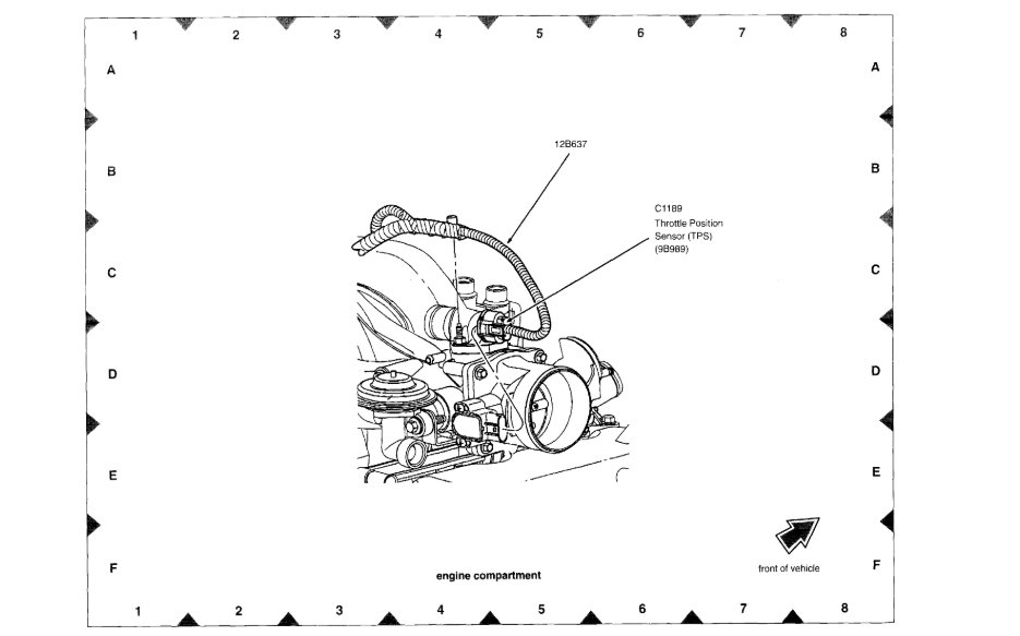

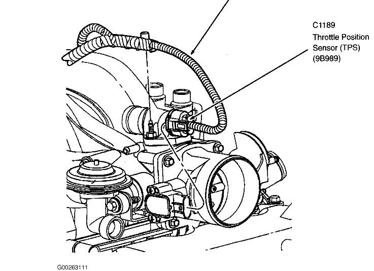

Does it have a air idle control valve?
Dec 14, 2018 at 9:22 AM
Good afternoon,
Yes it does. it is located on top of the throttle body. Check out the diagrams (Below). Please let us know if you need anything else to get the problem fixed.

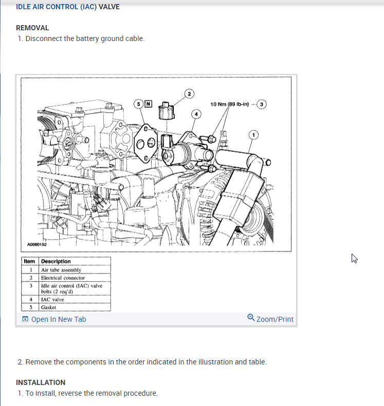

More then likely this would be the idle air control so here is a guide that will explain how to replace this plus a guide that talks about noises from a vehicle. Please take a look at number 6 on this guide that talks about this in more detail.
https://www.2carpros.com/articles/how-to-replace-an-idle-speed-control-motor-iac
https://www.2carpros.com/articles/engine-noises
Lastly below is the process from the manual on how to replace the IAC. Please let us know if you have more questions. Thanks
