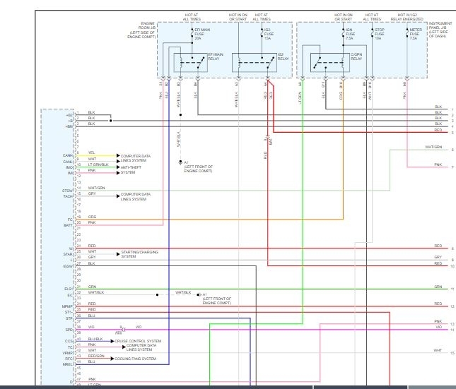

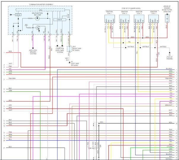

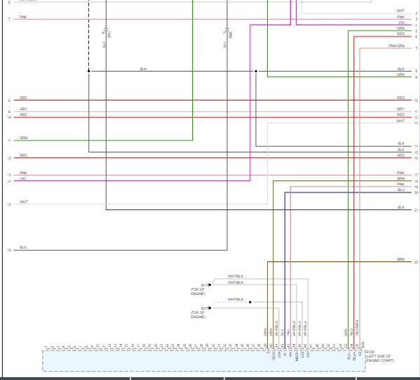

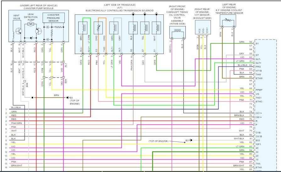

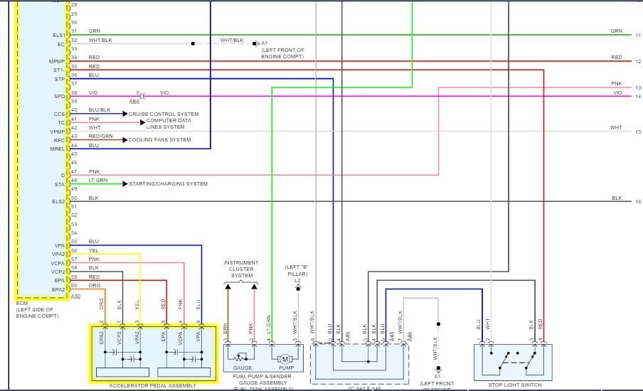

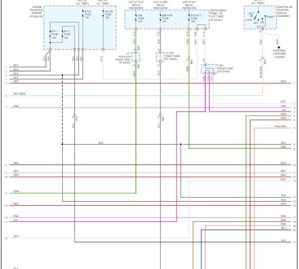

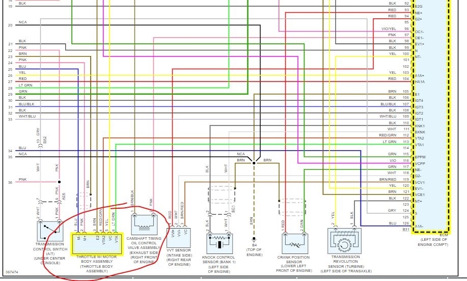

Good afternoon,
Is the check engine light on? If it is, do you know the code?
There could be several reasons for this.
1. Electronic control to the throttle body.
https://www.2carpros.com/articles/engine-has-low-power-output
2. Clogged exhaust not allowing the engine to breathe.
https://www.2carpros.com/articles/bad-catalytic-converter-symptoms
3. A mechanical issue in the motor.
