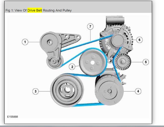

This sounds like you could have an issue with your vehicle's serpentine belt. The serpentine belt on your vehicle drives the water pump, A/C compressor, and also the alternator. The alternator is what charges your battery. If the alternator is not charging the battery the vehicle will run for a little bit until the battery is drained to the point where the Power-train Control Module (PCM) will start to shut down because it doesn't have the electricity needed to run. Sure you can jump start it and the battery will have enough juice to go 100 yards or so, but that's about it. Here are a few links below for you to go to:
https://www.2carpros.com/articles/how-a-serpentine-belt-works
https://www.2carpros.com/articles/how-a-serpentine-belt-tensioner-works
https://www.2carpros.com/articles/replace-serpentine-belt

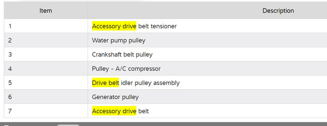

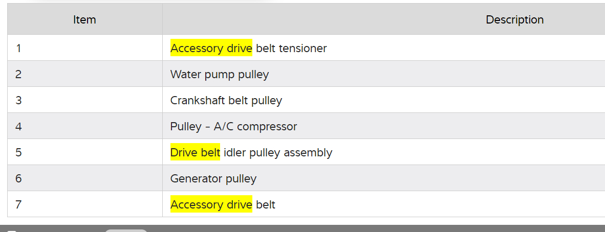

I have also included a diagram and callout for your vehicle's serpentine belt in the diagrams down below. Please go through these guides and get back to us with what you are able to find out.
