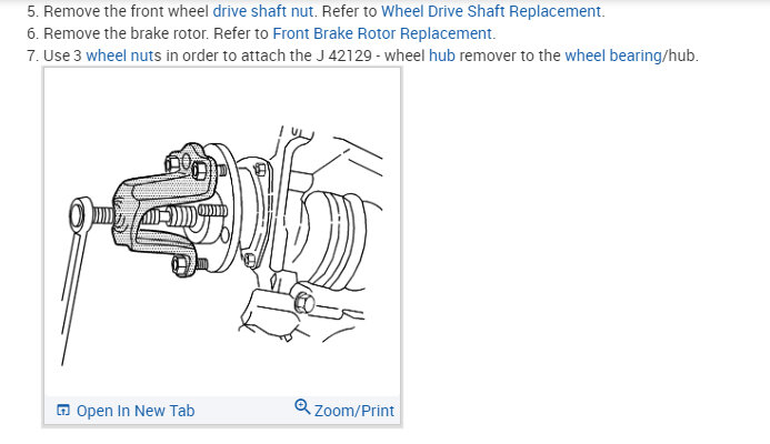

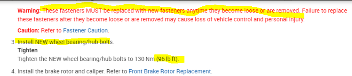

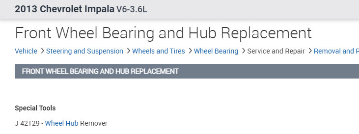

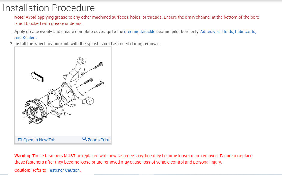

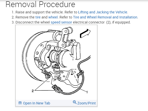

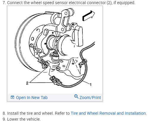

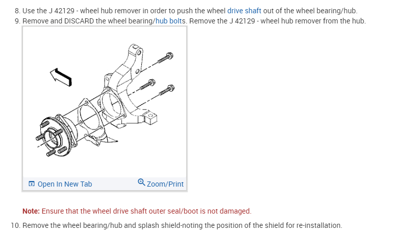

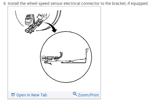

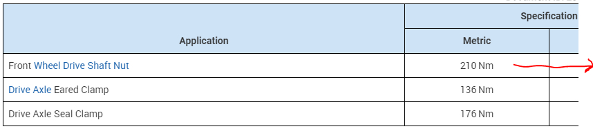

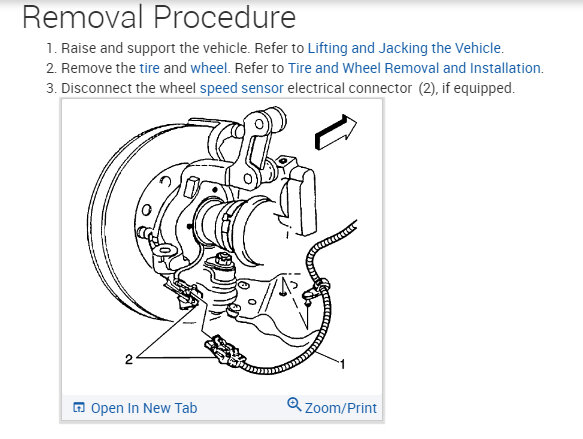

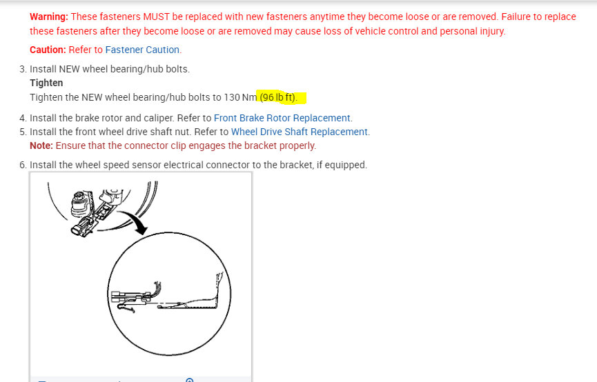

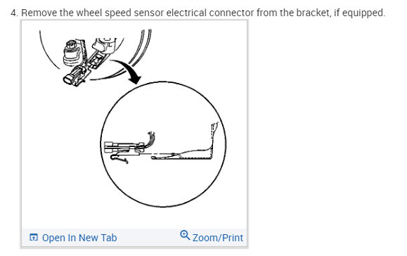

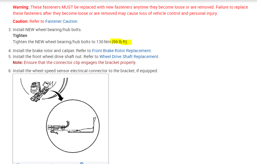

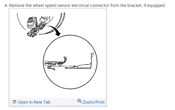

I attached the directions below along with the torque specifications. Take a look through them and let me know if anything was missed or if the torque specifications were not reached.
joe
See pics below.

Mine didn't need the wheel hub assembly puller. It was a 34mm socket to take the nut off then 3 bolts in the back. Or am I misreading but I didn't use a torque wrench heck could barely get anything on the bolt.

If they all came on at the same time, chances are there is an issue with one of the wheel speed sensors. That would cause all of the mentioned lights to turn on.
So, we need to figure out what is causing it. The new bearings would have come with new wheel speed sensors. Therefore, something is likely loose and may have damaged the sensor.

The bolts in the back of the knuckle. I have to use a socket and extension but the socket won't quite slide all the way down the bolt head so felt like wanted to slip. The socket off the bolt head that is. I'll check with parts store about torque wrench. When the lights went off the brakes made a horrible noise sounds like there was no brake pad. That's just what it sounded like. I'm going out to take apart now. I'll let you know thanks.

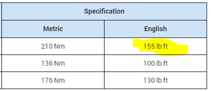

If the torque wrench doesn't go high enough, which isn't a surprise, return it. For this job, the axle nut needs to be tightened to 155 ft/lbs. I suspect the torque wrench goes to 150 ft/lbs. If that is the case, take it that far and give it an additional 1/8 of a turn and you should be fine.
As far as the hub bolts are concerned, they need to be replaced and the new ones torqued to 96 ft/lbs.
