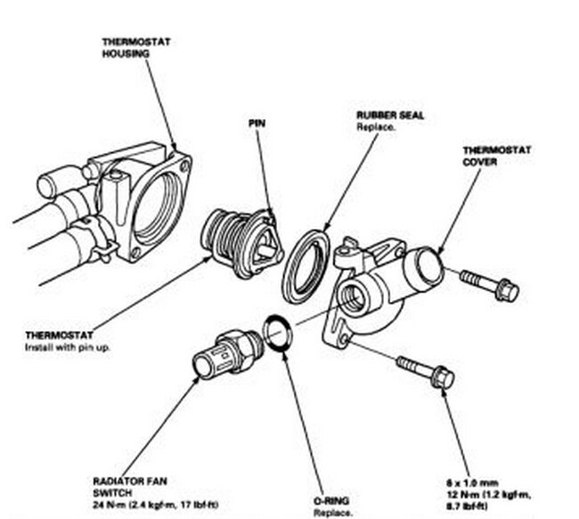

The other problem might be the radiator fan switch, located at the thermostat housing, lower right rear of engine. See image 2 below.
To test if this circuit is at fault simply disconnect the connector at the fan switch and insert a bridge wire from pin to pin. See if cooling fans run.
Cheers, Boris

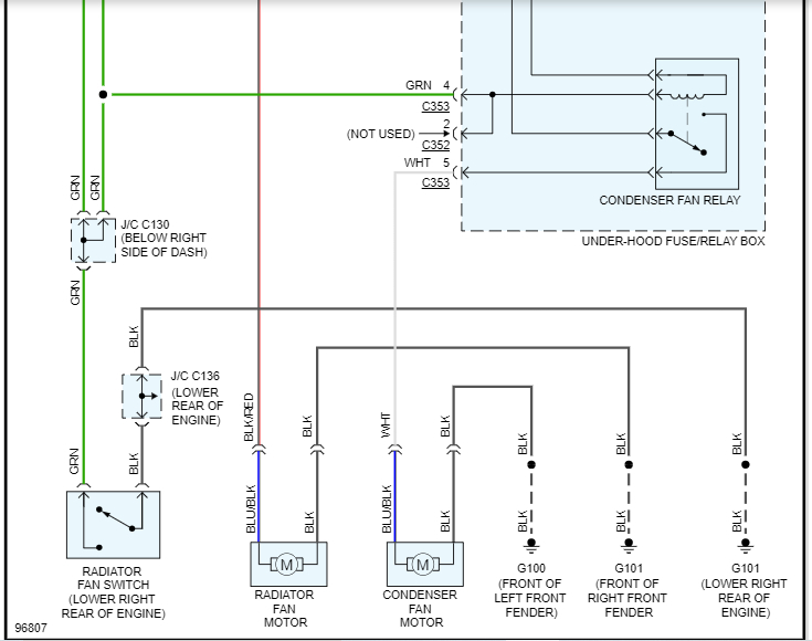

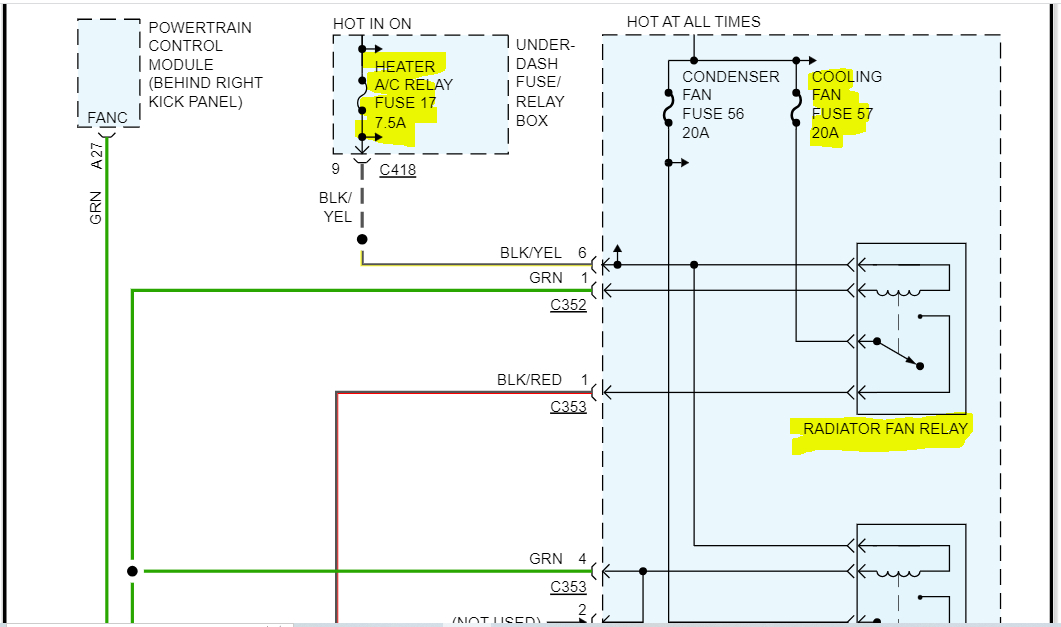

That is an odd one. I say that because you should be getting more airflow at highway speed than the fan can do.
I attached the wiring schematic for the radiator cooling fans. Let me know if you have already checked the fuses and relay, I highlighted. Note: When checking the fuses, confirm there is power to them.
Also, let me know how the relay was tested.
See pics below.

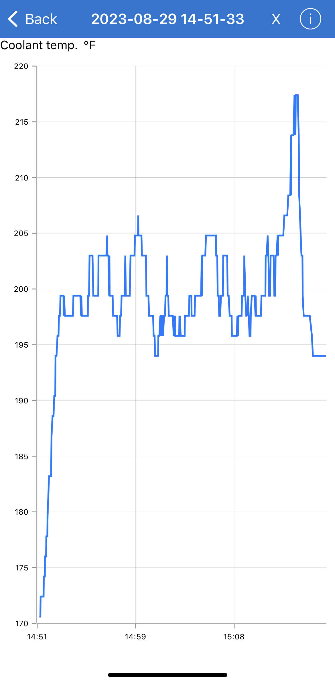

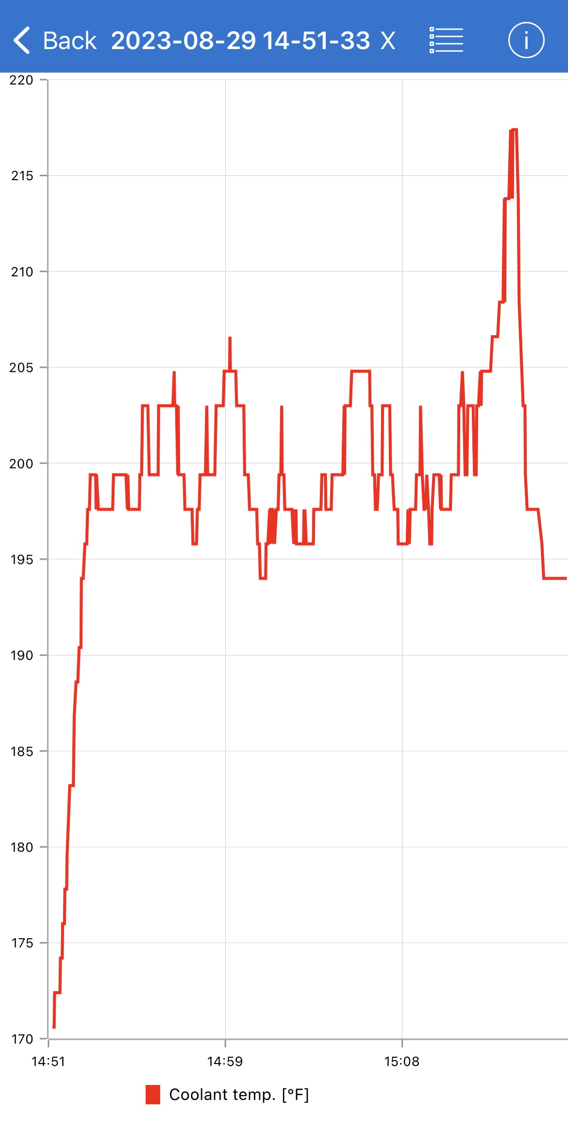

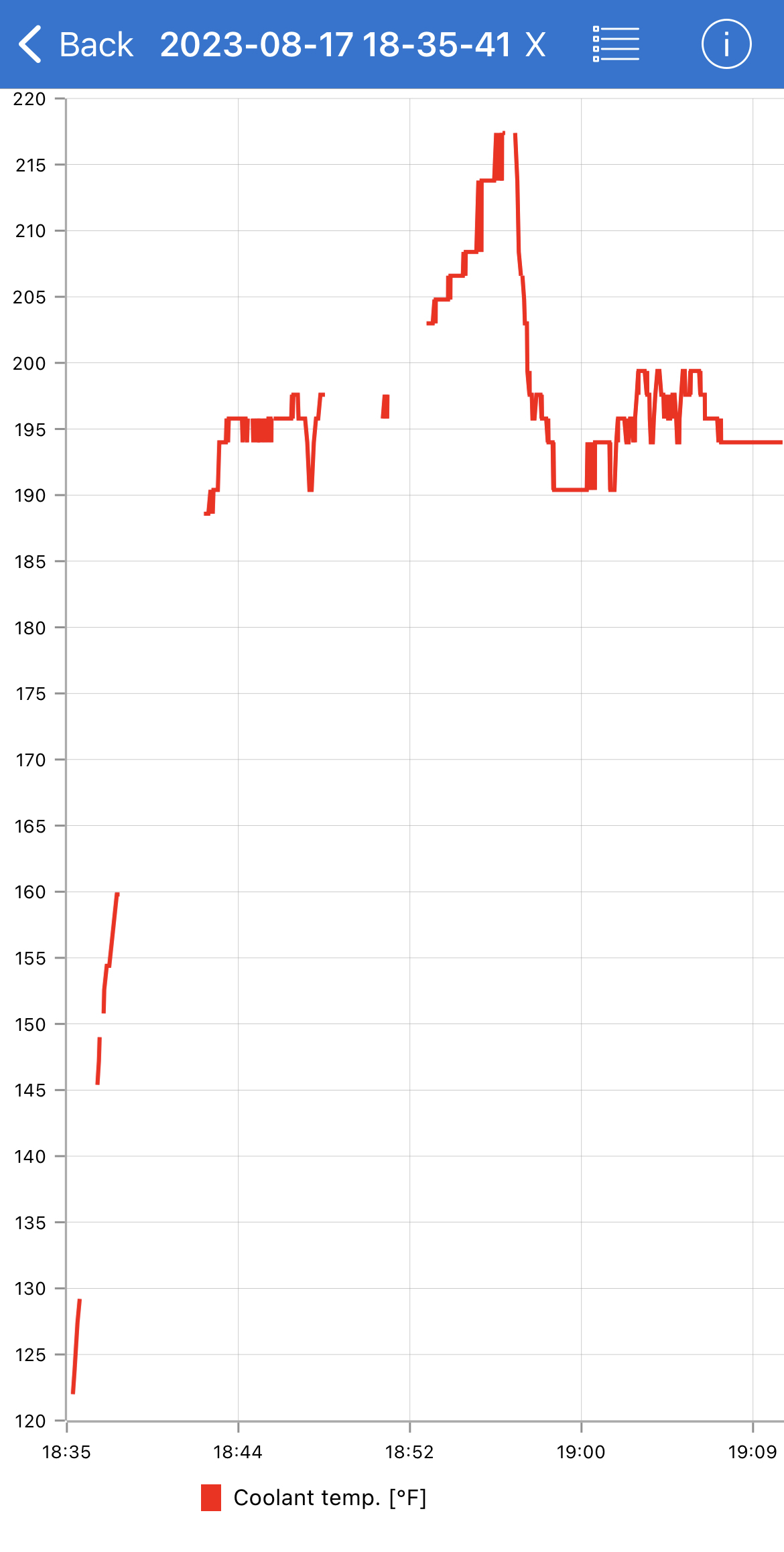

Thank you for your reply. I checked the fuses and relay, and everything worked. Today, I had the car parked and started it after I installed an OBD with Bluetooth. I saw the engine coolant reach 217* degrees and I could see the idle go up but then I heard something in the car, like something started, (not sure how to describe or explain) but dad said it was the fans starting. I noticed the temperature went down. From 217* to 197* to 194*. I decided to drive the car for maybe 5-7 minutes, I still don’t trust it and the temperature did not increase.
I am not sure if the problem is fixed. It went up then down. All of this, including the driving with the A/C off.
See attached image of car temperature.
Aug 17, 2023 at 9:23 PM
That sounds like it did exactly what it is designed to do. Drive it and don't be afraid; be aware. Keep an eye on the temperature. If you notice it getting too high, find a safe place to park and allow it to cool. Hopefully, it won't.
If anything changes, let me know. Also, if you have other questions, feel free to ask away.
Aug 18, 2023 at 9:08 PM

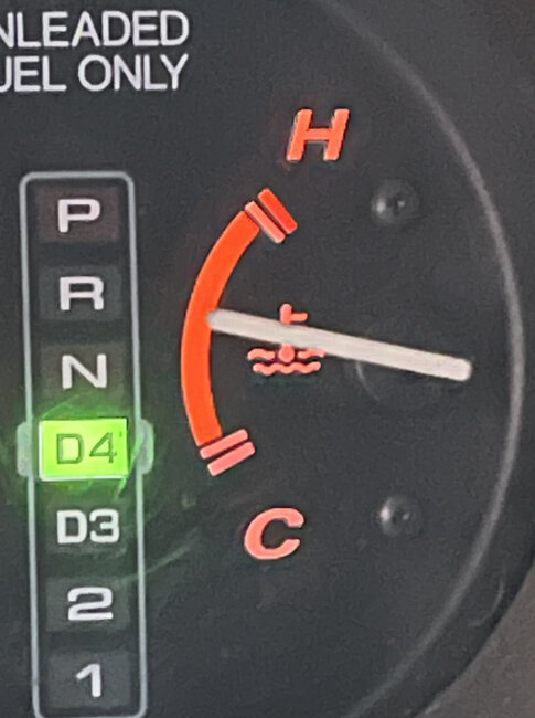

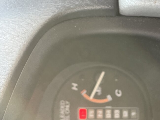

Thank you. I have had that car for 10 years now and I have never seen the idle (temperature) go up, the fans start and then go down. That part doesn’t make sense to me. My dad’s car doesn’t do that and that’s the reason I don’t trust it. Or
Maybe I need to drive it more.
Attached is an image from last month. The car “needle” got that high and on Wednesday kind of looked like that and then the fans started. I have never seen my car idle do that and start the fans.
Thanks again Joe.

I guess my point was, why the delay? Why does the temperature idle go all the way up and then the fans start? That delay is driving me crazy.
Aug 19, 2023 at 4:01 PM
I understand. That is higher on the gauge than I would expect before the fans turn on, but the temp you mentioned (217F) sounds normal. Also, the increase in idle speed is by design. It does that to compensate for the added load when the fans turn on.

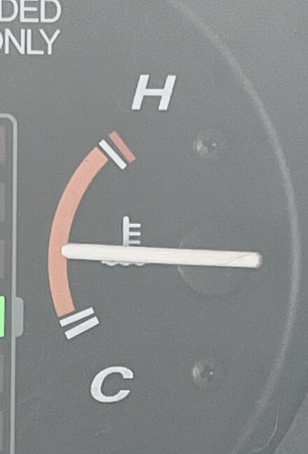

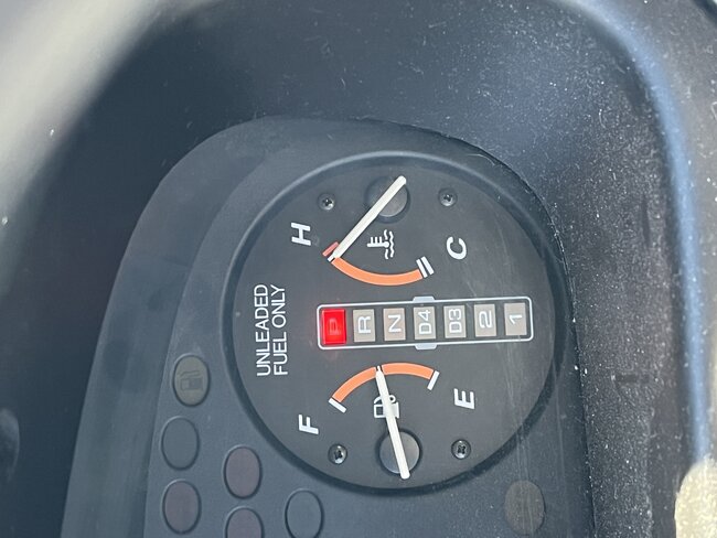

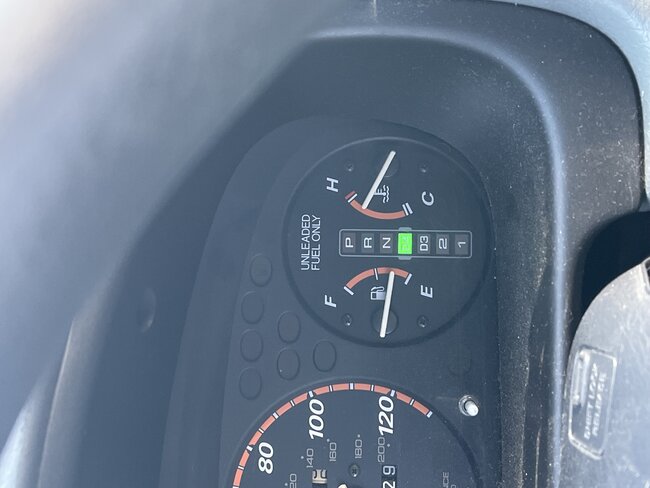

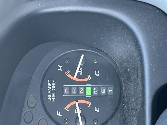

Hello. I drove the car twice today. I am honestly not sure to say that the car is fixed. The first time, the temperature went up somewhat high, and came down as soon it went up. The second time, it went a little up and it took its time to come down.
When can I say that the car is fixed? Do I need to check something else?
Drive it more?
See attached pictures.
Thank you.
Aug 21, 2023 at 7:17 PM
If that is where the temperature gauges are staying, it should be fine. I'm not sure where you are located, but if the temperatures are extremely high, the engine will likely run a little hotter.
The best thing to do is drive it and simply keep an eye on the gauge.

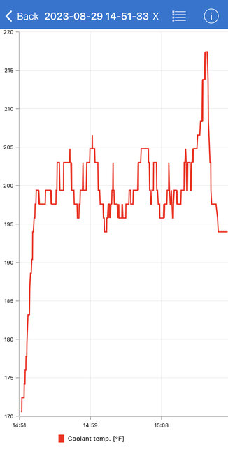

See attached.
Aug 29, 2023 at 2:07 PM
Since it doesn't overheat with the A/C on, the condenser fan is working. I looked at the temperatures you attached above. In all actuality, they are not out of the norm. The fan may start operating when the engine coolant temperature reaches around 210 to 220 degrees Fahrenheit. You are within that range.
I just don't want to see you spend money and nothing change. Remember, when the A/C is on, the condenser fan runs at all times. With it off, the temp has to increase until the radiator fan turns on. If you are in the range I mentioned, I feel you are okay. Also, since you were at idle in a drive through, the under-hood temperature will increase.
Let me know if you have questions.

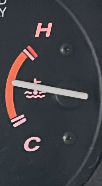

No problem whatsoever. I just hope I'm helping. Do me a favor. When the gauge goes to its highest point, take a pic and upload it for me. I don't feel there is an issue with the fans, but perhaps there is something going on with the gauge. It's unlikely, but anything is possible. And like you, I like to know everything is okay.
Aug 30, 2023 at 6:54 PM
ROCKA
  • 22 POSTS
Hello. I couldn’t upload the picture properly but that is what it looks like.
Sep 3, 2023 at 3:57 PM
The picture is perfect. No problem whatsoever.
Is that the highest it gets before the fan turns on? If it is, no worries. That is where I would expect approximately 220F to be. As long as once the fan turns on and the temperature comes back down, it is fine.
