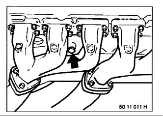

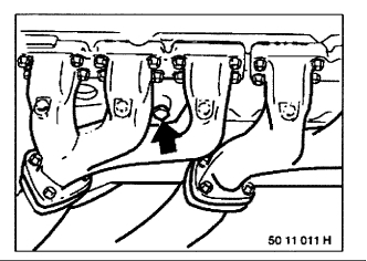

Note: M52/S52 The water drain plug is located on the exhaust side between cylinders 4 and 5 in the engine block (illustration).
M52TU / M54 / M56 The water drain plug is located on the exhaust side on cylinder 2 in the engine block.
Drain and dispose of coolant.

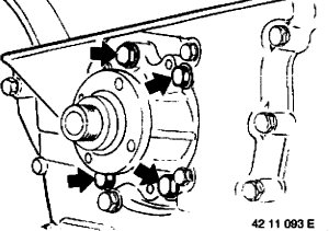

Release belt pulley.
Release water pump.
Tighten two screws (M6) into thread of water pump and water pump out of timing case.
