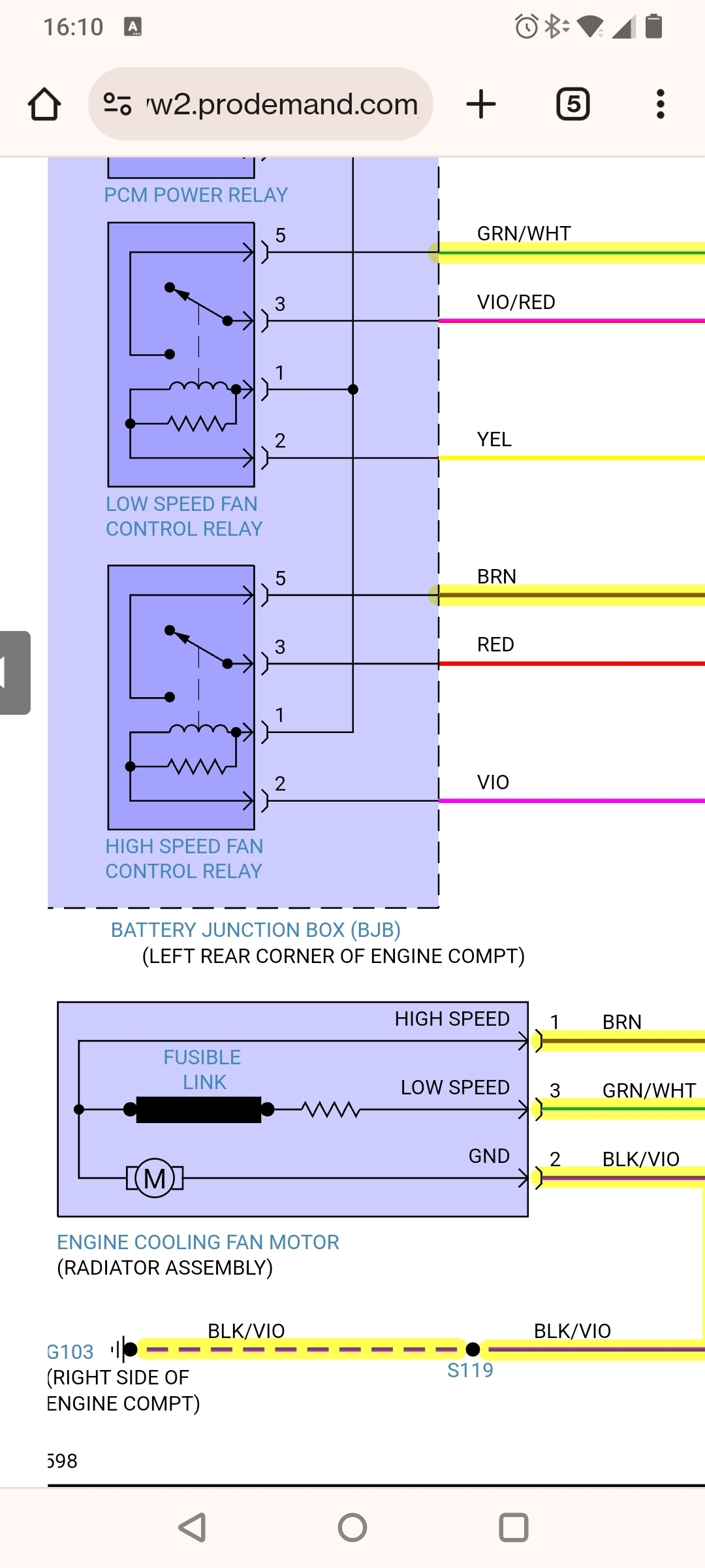

I checked the black/violet ground wire with a test probe, and it did light up, so then I checked fuses 14, 16 and 17..Fuse 17 ended up being bad so when I replaced it, I hooked up Forscan and watched as the car reached normal temp. It didn't turn on when it showed the low speed fan turning on but the high-speed fan did come on so now the high-speed fan works but the low speed doesn't.

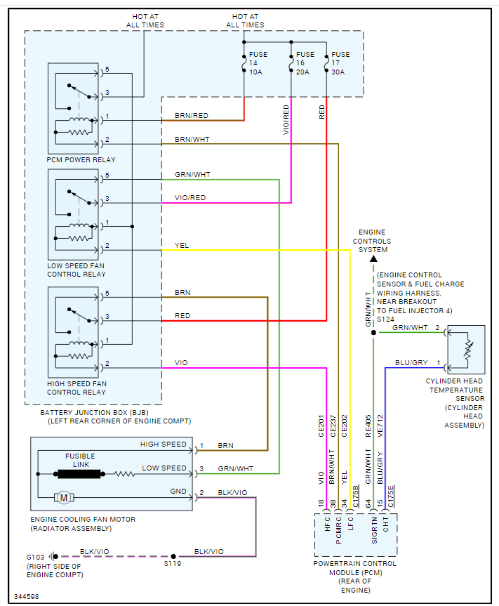

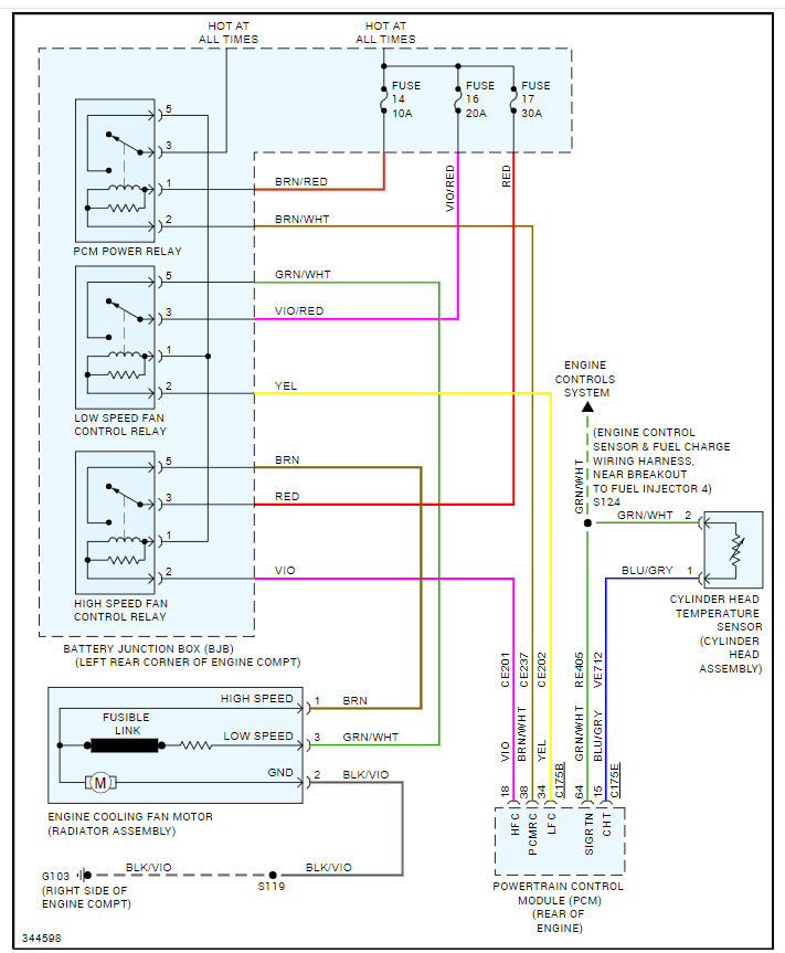

Can I ask if you turn the A/C system on if the fans run? Also on your scanner what is the engine temperature? You could have a engine coolant sensor that needs to be replaced, here is the complete radiator cooling fan wiring diagrams so you can see who the system works. With the low speed fan on please check the grn/wht wire for power, if it has power then let's check for ground on the blk/vio wire and the cooling fan is not working the fan module is bad.
