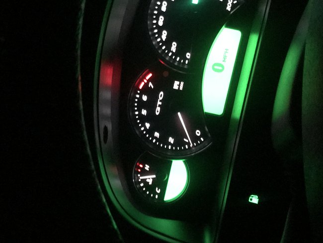

Temperature gauge is high not in the red but gets high. cooling fans run all time as soon as I turn on car the cooling fans run and don’t shut off until car is off.
