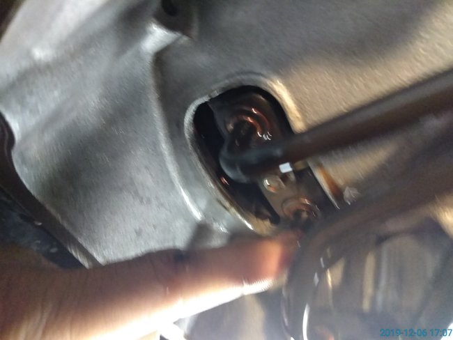

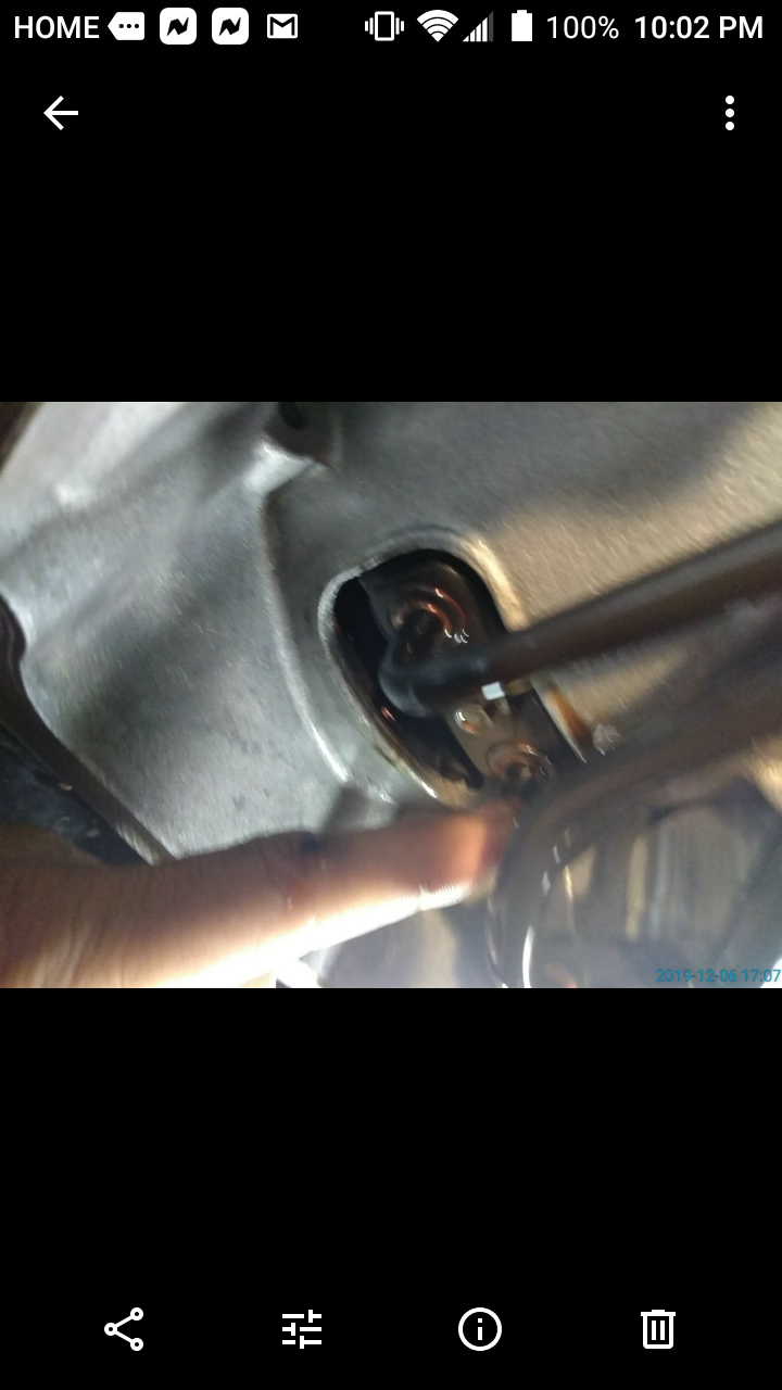

Thank you. found the problem. I dropped the transmission pan oil was dirty but I checked the transmission supply lines inside the oil pan sure enough 1 line had failed at the weld. it was completely detached. you have to check very good at the welded points or you won't ever know the problem. One shop had already told me I need a transmission. remove the 5 little screws it comes right off I replaced the part for $10.00.

Here's a picture of the part.
Dec 12, 2019 at 4:21 PM
Wow, they just do not make them like they used to.
