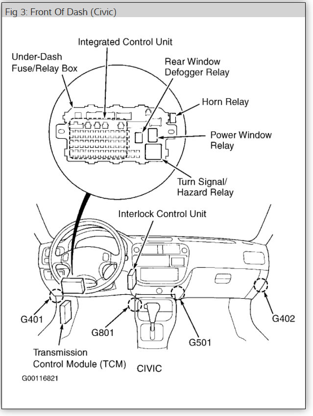

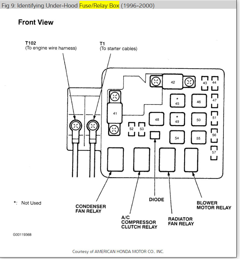

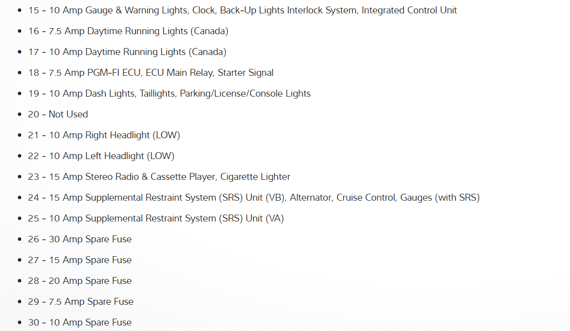

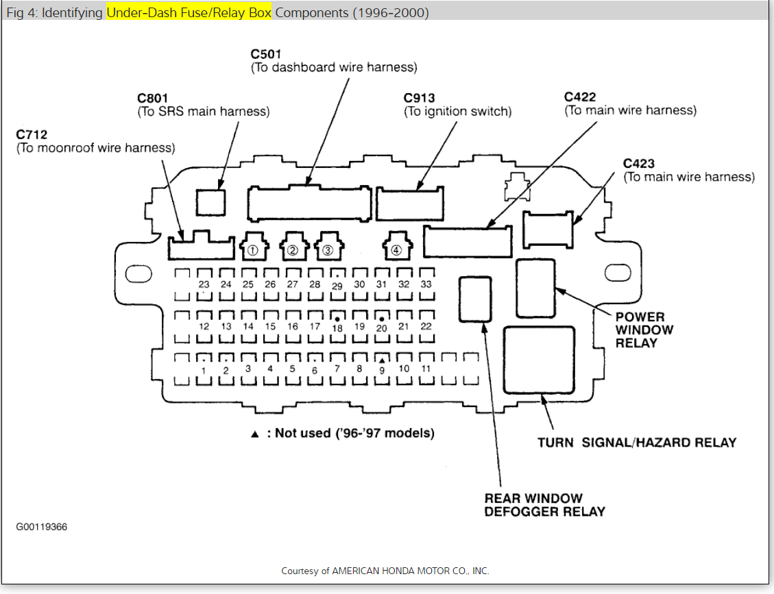

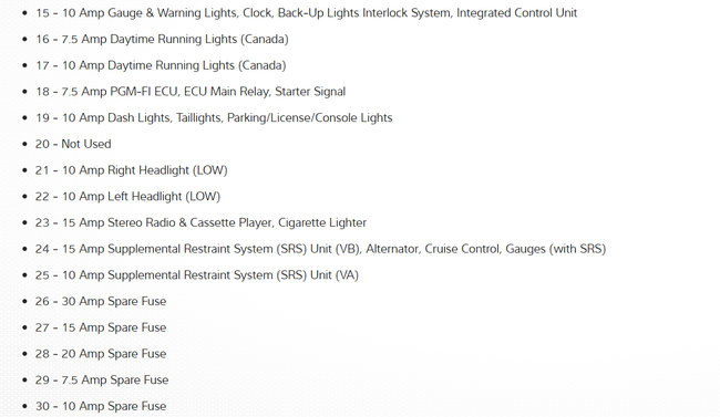

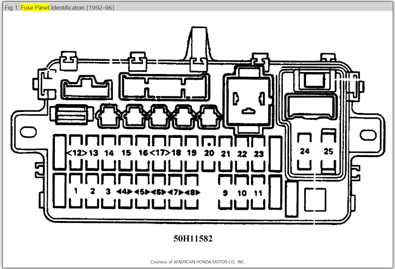

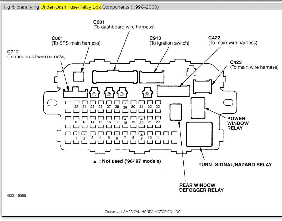

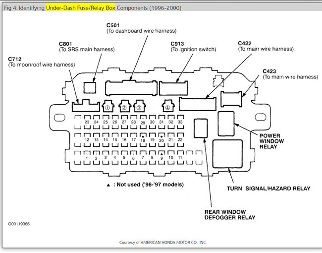

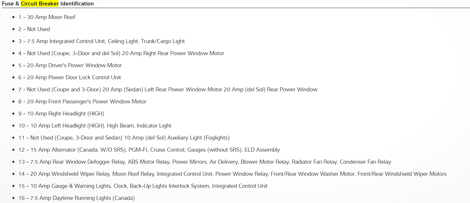

Was there any sparks when doing the job? Let start by checking all fuses. here is a guide to help with the fuse locations in the diagrams below:
If all okay please check the battery cable connections this guide can help:
