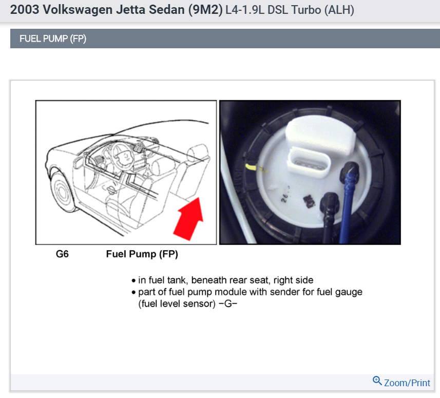

The fact that the pump is noisy and other times not is telling me the fuel pump is going out. Here is a guide to help you see what you are in for less the dropping of the tank because you do not need to to replace the pump.
