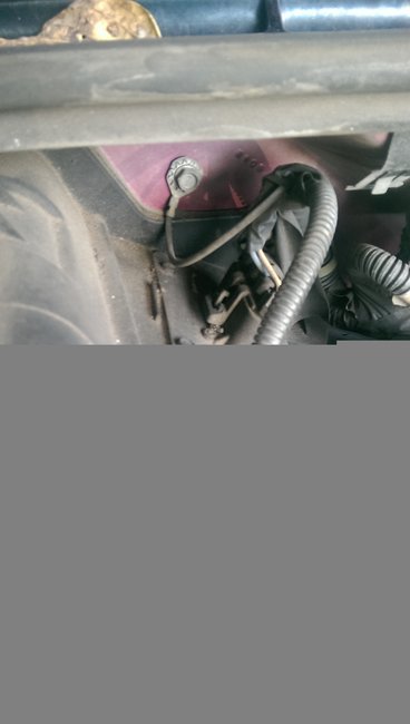

This is the only other i could find attached to the frame is this the other ground?
Sep 12, 2016 at 4:06 PM
HMAC300
  • 48,601 POSTS
that is a body ground not frame just turn one to the frame. this should really be checked out by a pro instead of these endless emails. when the battery was load tested how far did voltage drop? if it went below 9 volts the battery Is bad and it should read at least 12.4 volts when at a low charge if it reads below then it's bad.

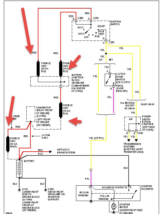

MERLIN2021
  • 17,250 POSTS
I will tell you this, if the positions on the switch work, acc, on ,start springs back to on, then you may have a bad fusible link, tug on the thin wires that connect to the starter, if they stretch, replace the link! If the switch position dont work replace the switch...

HMAC300
  • 48,601 POSTS
check items in pic
May 18, 2019 at 11:03 AM (Merged)
