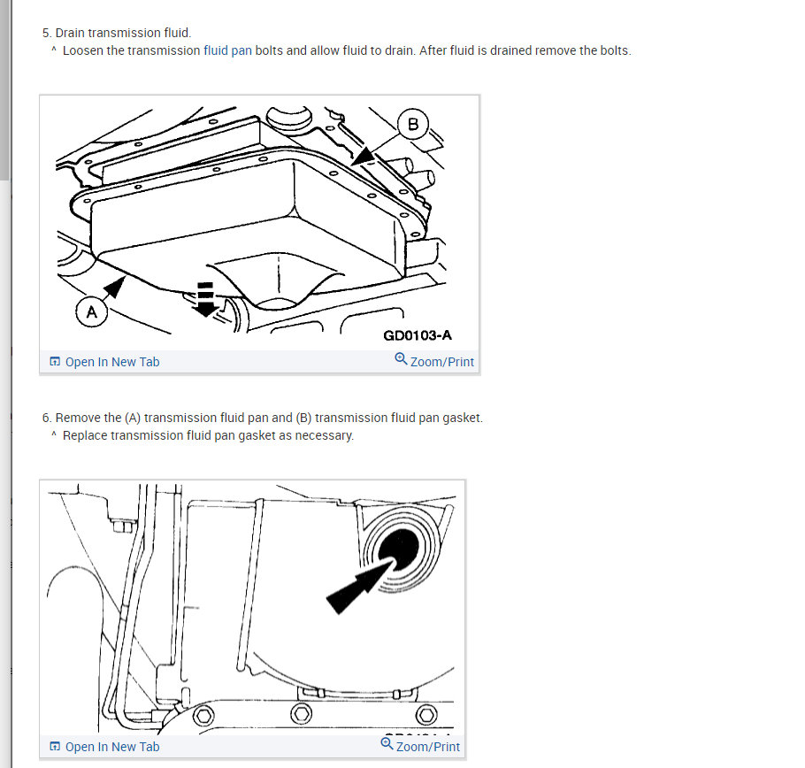

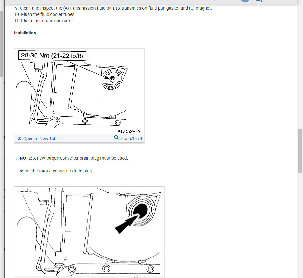

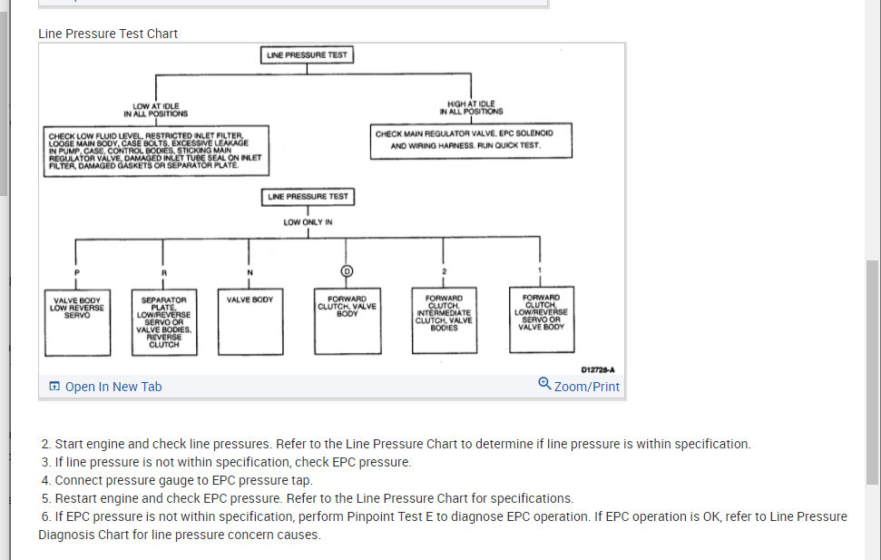

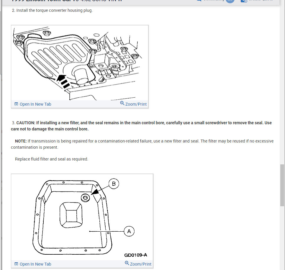

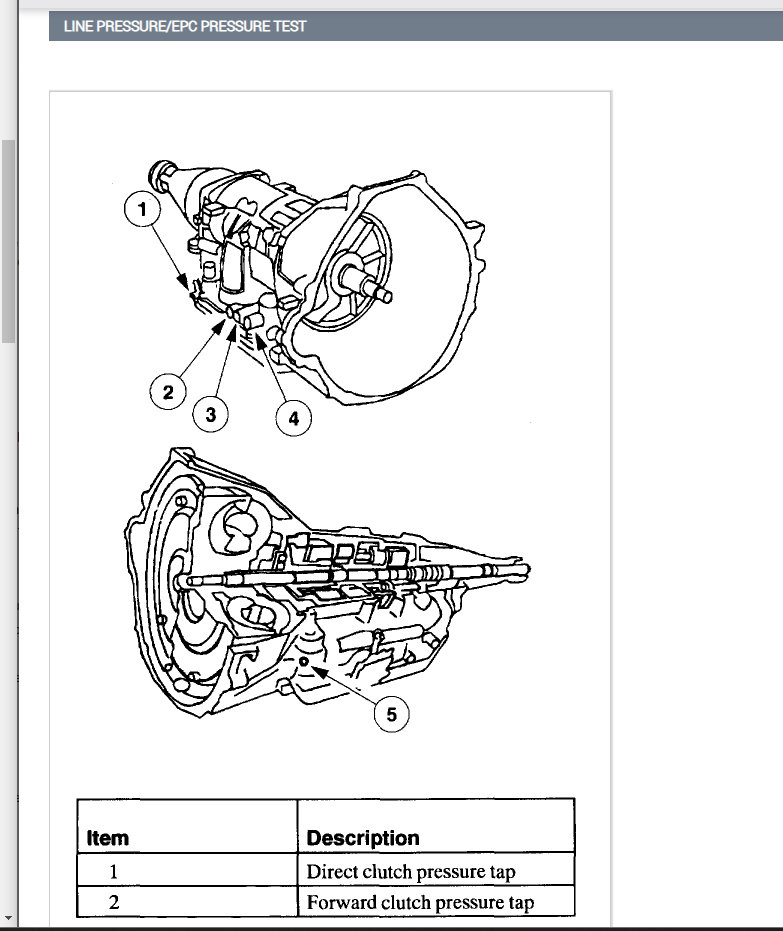

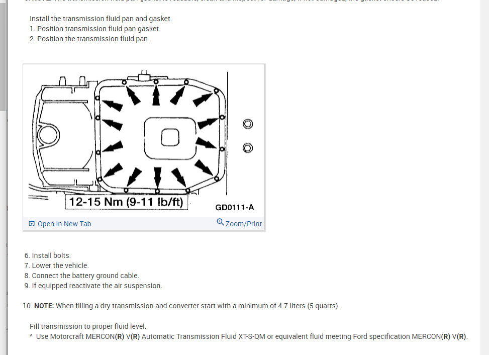

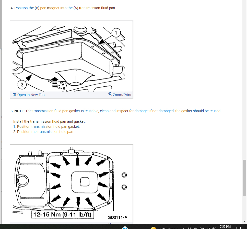

My car listed above will not go (move). It will not even engage when the transmission gear cable is manually put in drive, or reverse. It's not doing anything. Help I'm confused.
