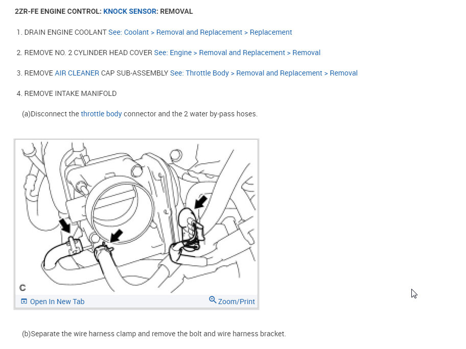

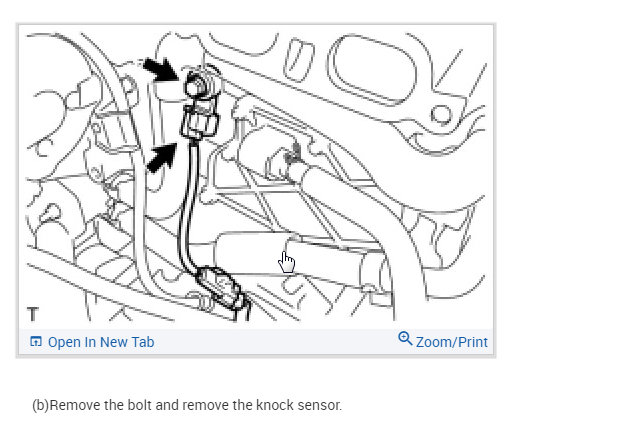

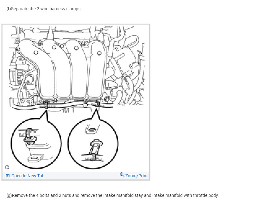

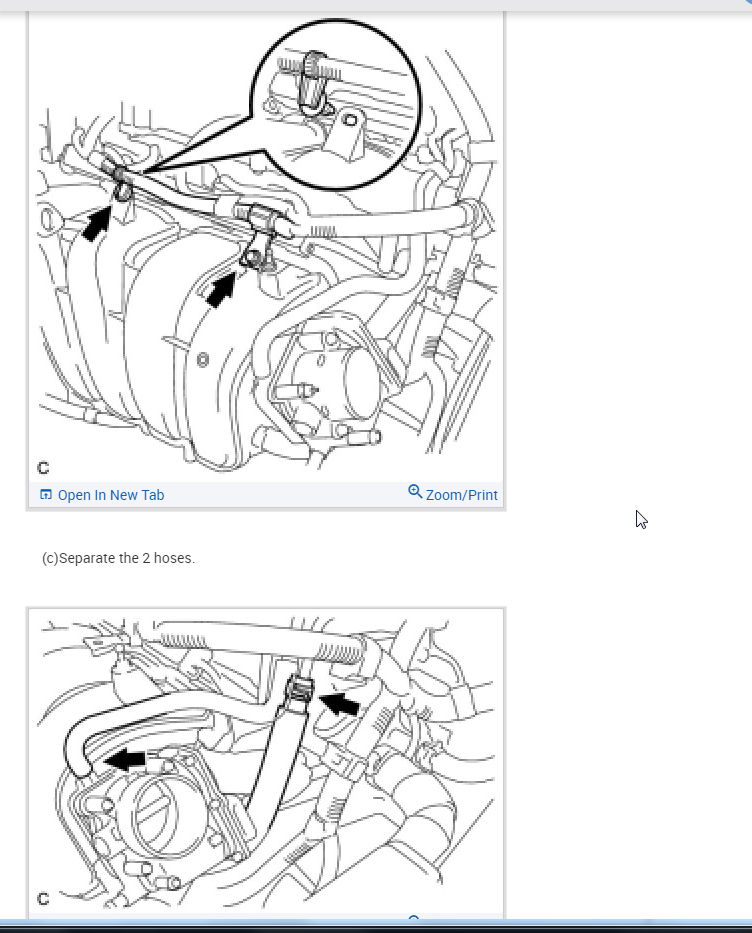

Please can you tell me or show me the location of knock sensor 1 for Toyota corolla 2012 2ZR,the car is not selecting last gear,so when I scan the car is complaining of knock
sensor 1.
