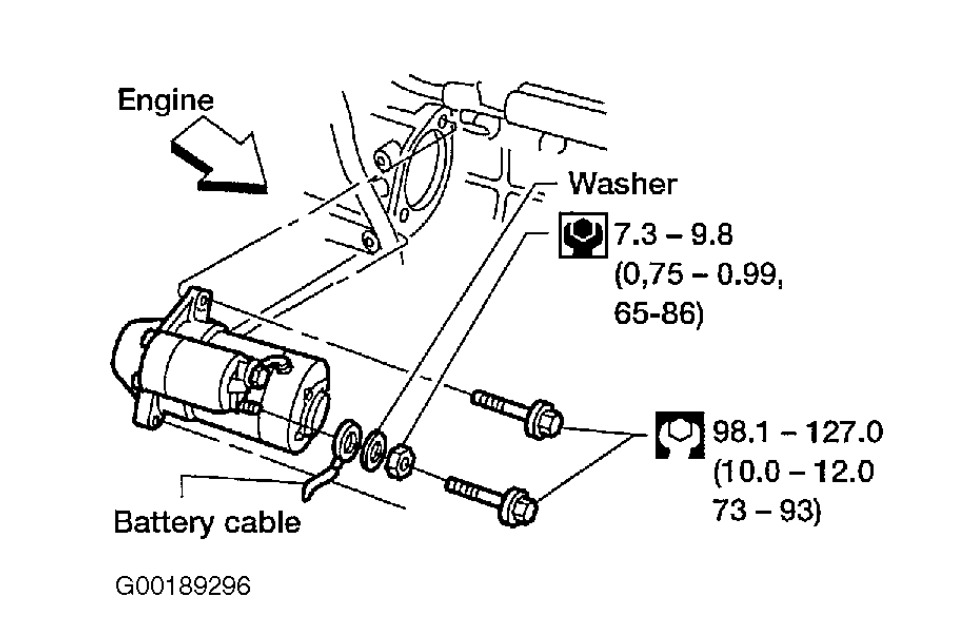

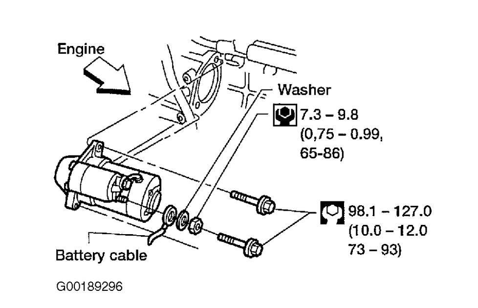

RATFACE
how many hours to replace a starter motor in a 2002 nissan almera is it difficult to get at,do i need to remove the exuast pipe to get at it.do i need special tools.would it bee better to get a mechanic to do the job and how many hours would he take. i cant stretch this question any further. ratface
Mar 11, 2021 at 6:57 PM (Merged)
HMAC300
  • 48,601 POSTS
sounds like the starter is bad. Here is a guide to help you step by step with instructions in the diagrams below to show you how on your car.
Check out the diagrams (Below). Please let us know what happens.
