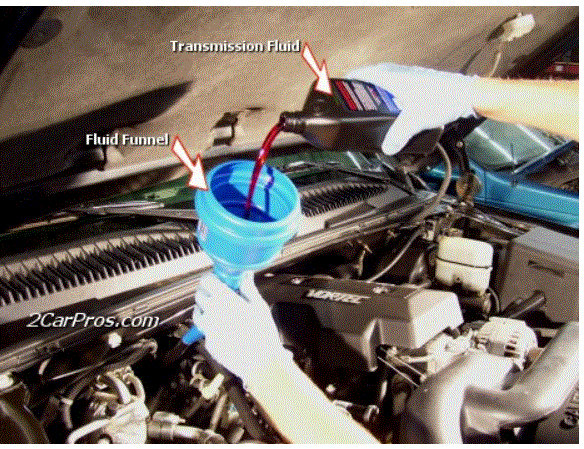

When you say it leaks oil, are you referring to engine oil or transmission fluid? Transmission fluid will have a redish color. I attached a pic so you can see the color of it.
Let me know. Also, let me know if you have identified where the leak is located.
