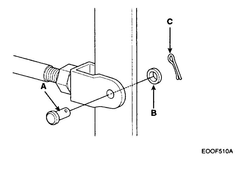

Do you have a good clutch pedal? Does it feel correct with the correct amount of free play?
Are you losing clutch fluid?
I attached a picture of where you adjust the clutch pedal free play. If you loosen this nut and turn the shaft into the master, you can adjust the length of the throw to the slave cylinder.

I have adjusted the clutch pedal and it feels great. But still not going into gear.
