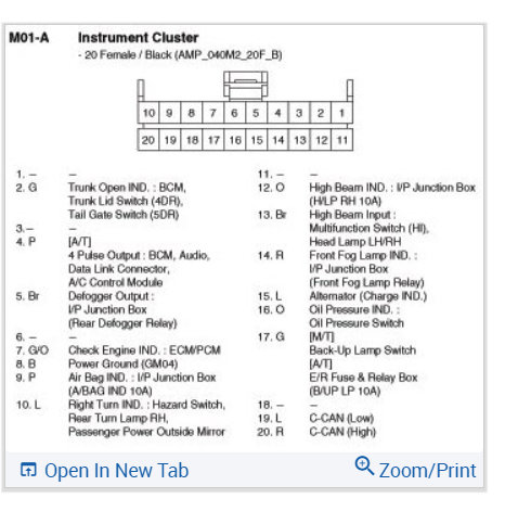

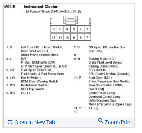

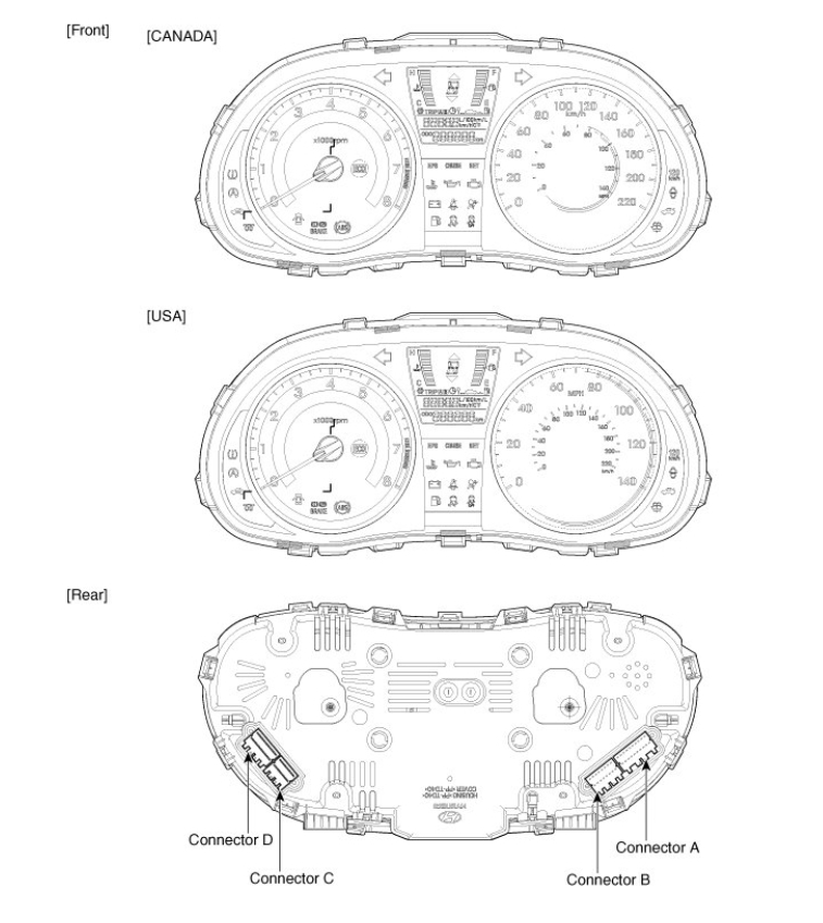

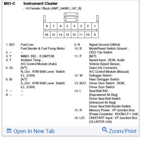

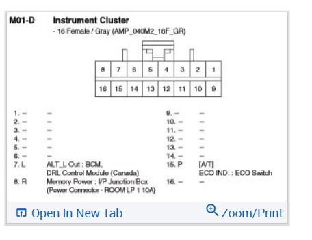

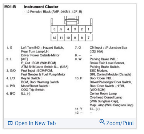

Chances are you cannot interchange these clusters. To be sure check the wiring connector at the rear of each cluster. If the same the new cluster may need to be programmed by a shop to work should cost about $130.00. Check out the diagrams (below). Please let us know what you find. We are interested to see what it is.
