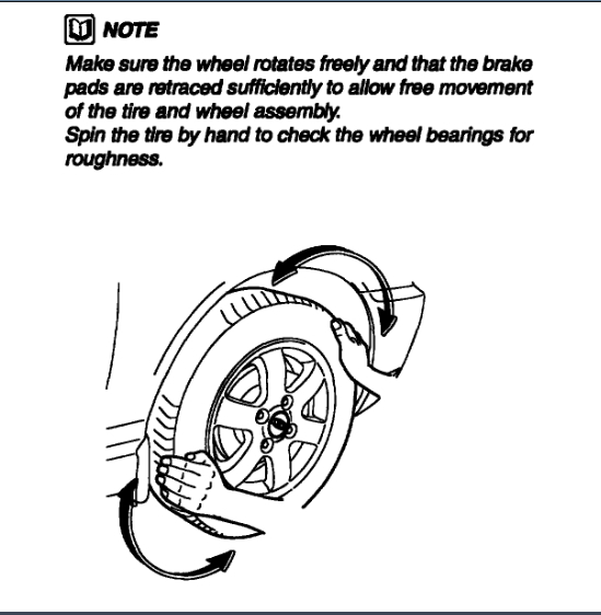

Sorry hopefully the other 2 videos upload because they have audio on them but yes when turning it makes a sound I want to say when turning left is louder also when I let go of the wheel the car starts pulling to the right. When I go over 60 mph it has a little vibration in the wheel. I've been watching a lot of videos and the best one to describe the noise is like putting a card up to the spokes of a bike tire while it's spinning but not so loud. I'm going to jack up the front end of the car now and see if I put my hand on the spring thing and spin the tire and see if I feel a vibration in it.
Jul 18, 2023 at 10:18 AM
$AVAGELOVE187
  • 9 POSTS
So, i jacked up the front end and held onto the springs things by tire while spinning it and there was a vibration on the right side. So, at this point I'm assuming it's the wheel bearings. So, my next question is, could I get the grease and grease the one in it to get me home which is about 5-hour trip and then get it replaced or get a new one?

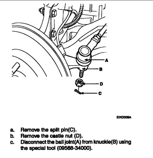

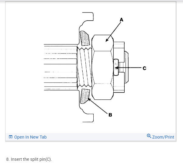

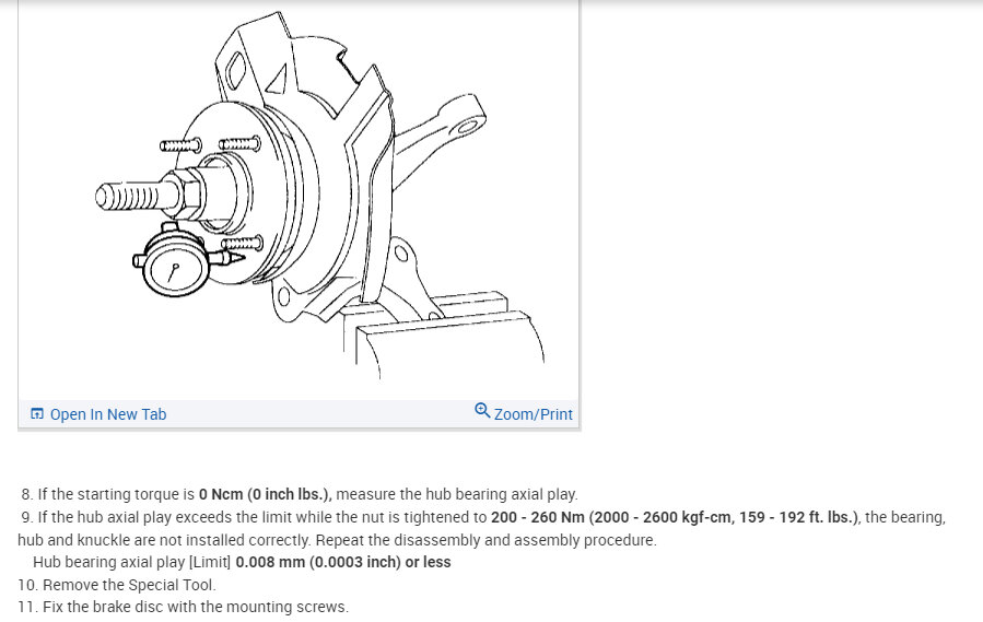

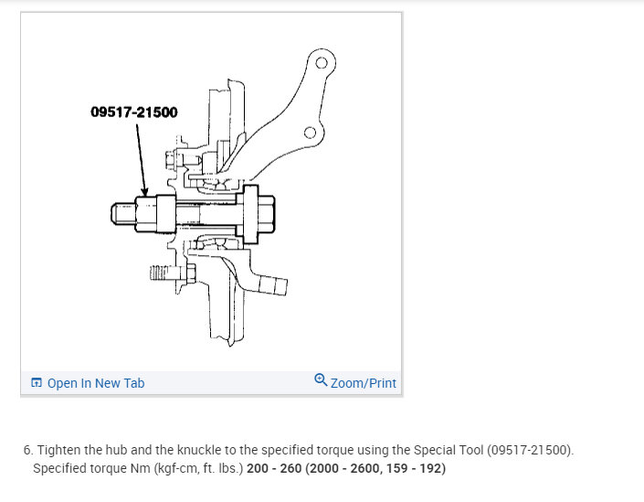

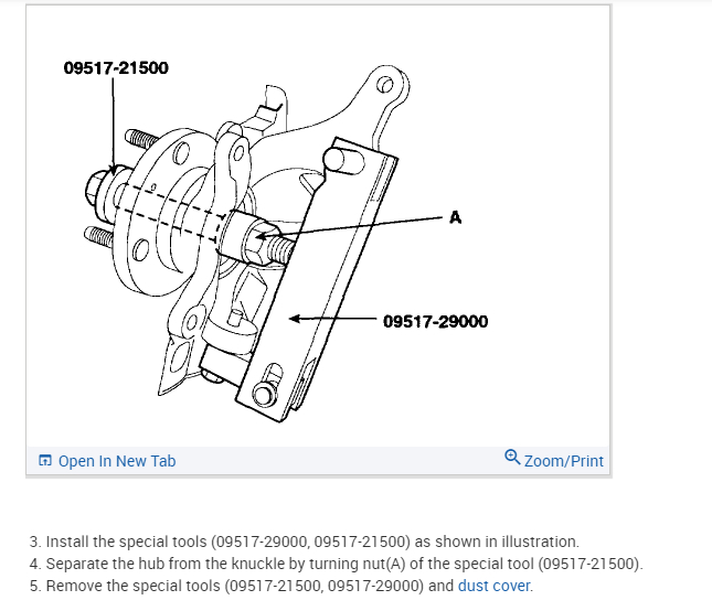

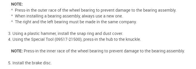

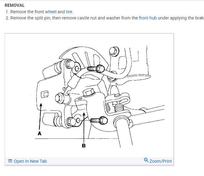

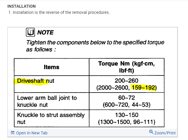

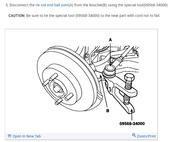

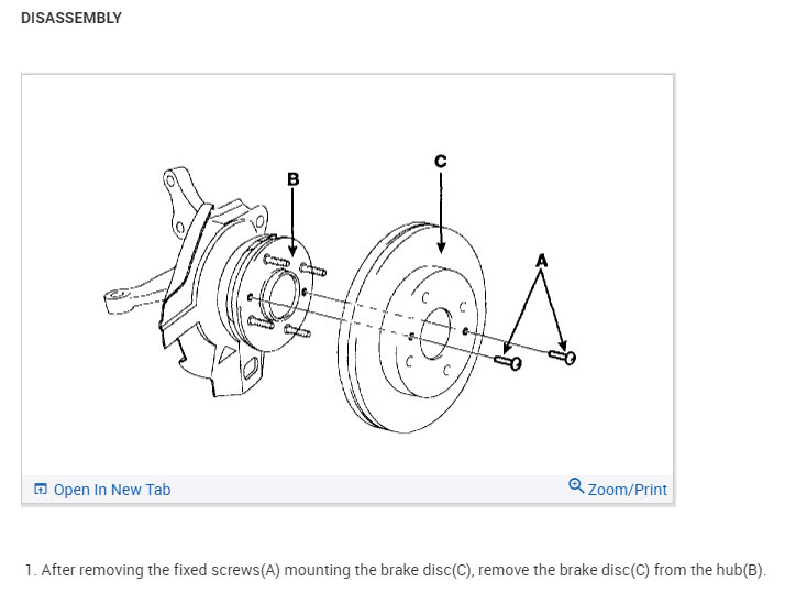

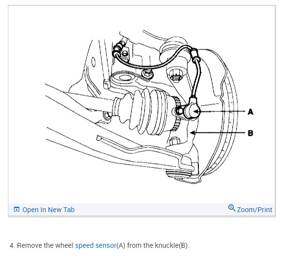

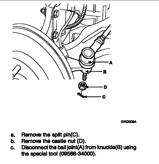

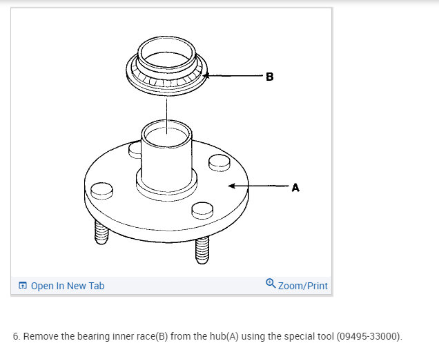

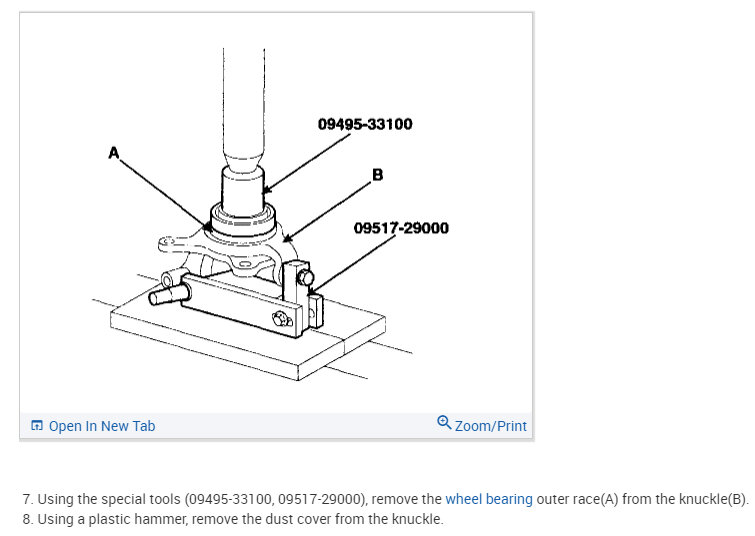

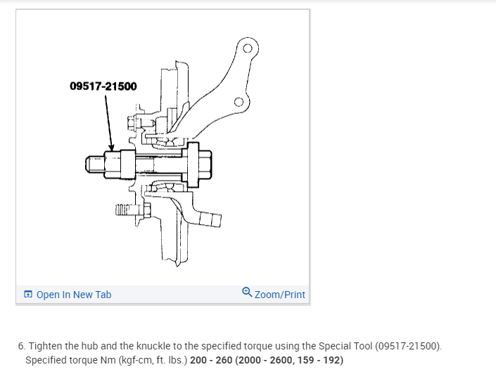

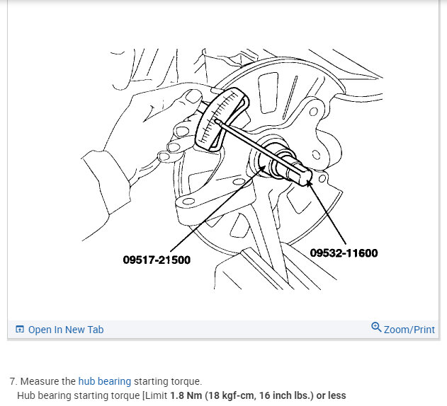

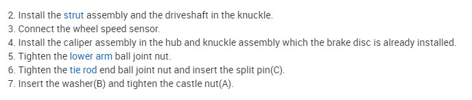

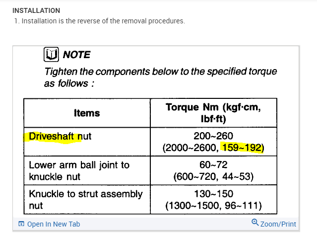

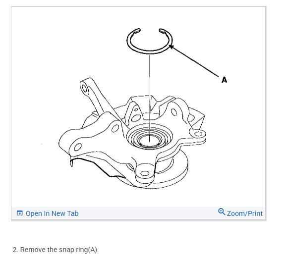

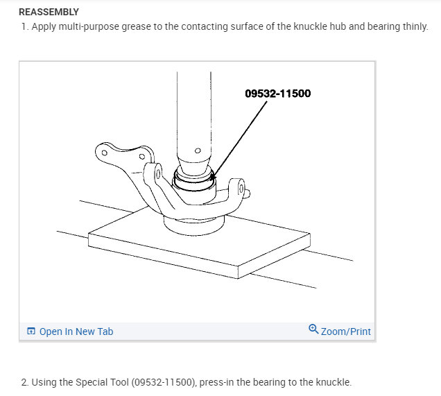

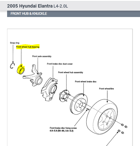

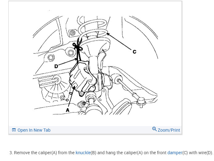

If you have to replace the front wheel hub bearing, it requires a press and some specialized tooling. It's actually a somewhat big job. Also, you can just replace the bearing.
I attached the directions below. Take a look through them and let me know if you have questions or if I can help.
See pics below.
