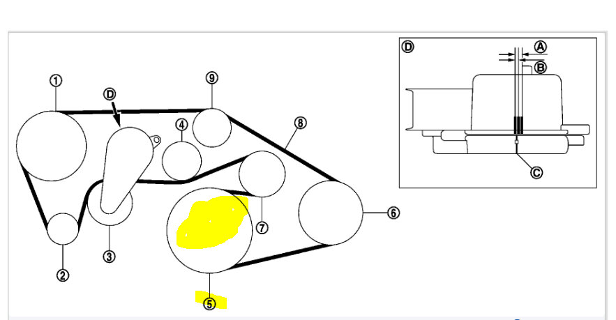

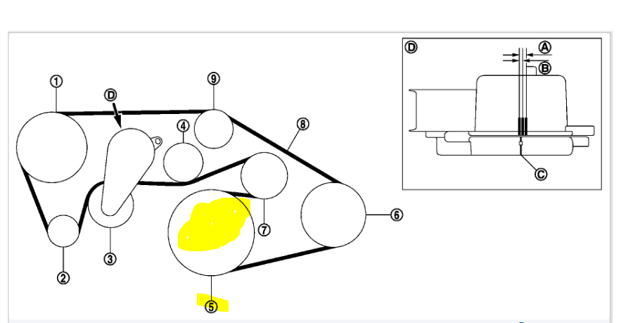

If you look below, I attached the serpentine belt routing diagram. I highlighted the crankshaft pulley. There will be a bolt centered in that pulley. You need to place a socket on it and using a breaker bar, see if you are able to turn the engine by hand. It will be tight, but you should be able to turn it.

See pic below.
