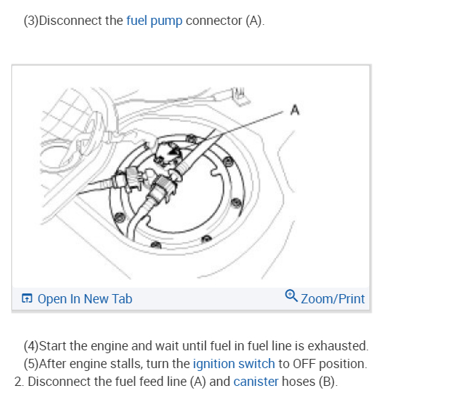

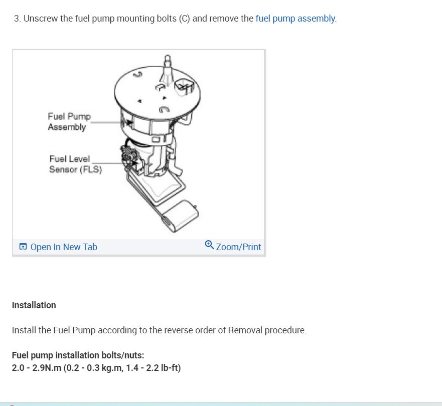

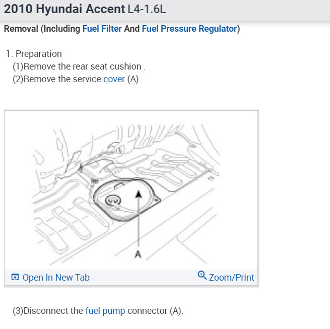

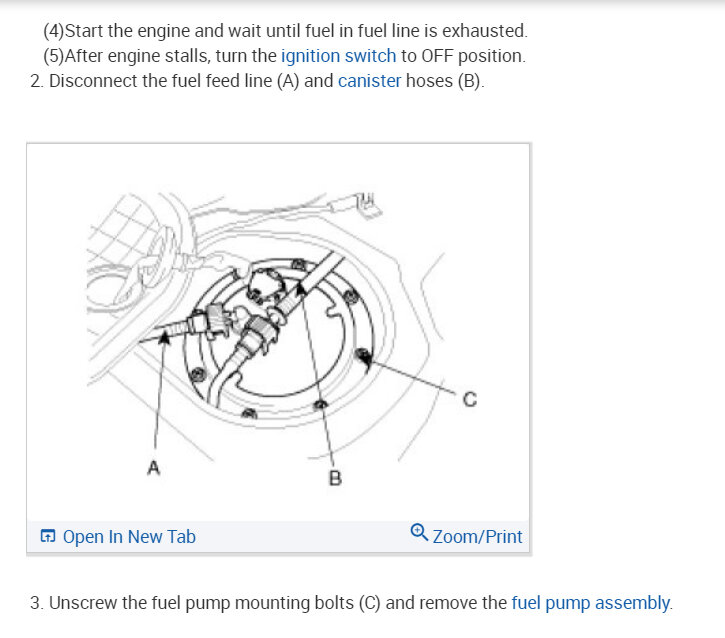

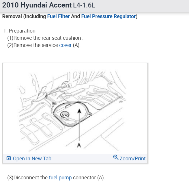

I clogged fuel filter would be #1 thing I would try first, here are the instructions on how to change it out and I have included a guide you can go over as well. Please check the air filter as well.
https://www.2carpros.com/articles/engine-has-low-power-output
Check out the images (below). Please let us know how it goes.
