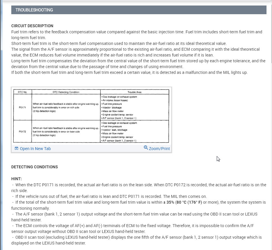

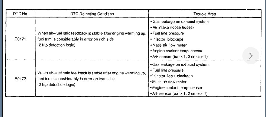

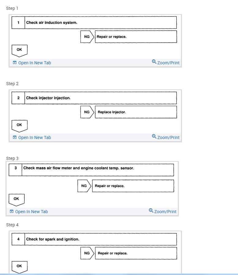

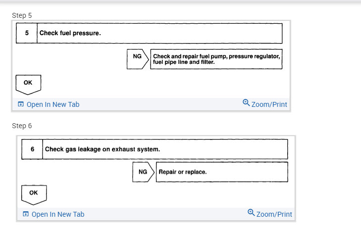

Car won't rev past 3,000 or 4,000 RPM's, hesitates to pick up speed past 1/2 throttle.
Seller said it was an oxygen sensor but I also bought fuel filter in case it might be a fuel problem.
Is there anywhere I can start from to test it?
