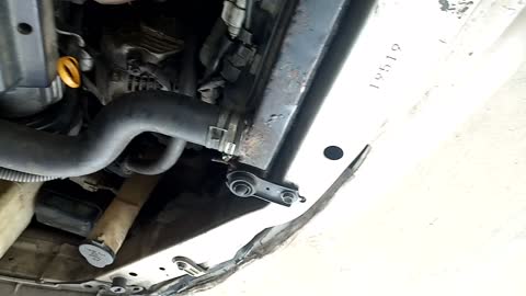

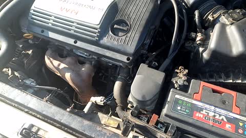

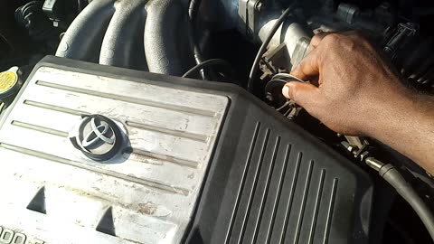

After a major engine dissembling and fix, the camshaft position sensor p0340 code came up, meanwhile the engine had difficulty in starting to confirm the failed sensor at bank 1. Please note during this period once started, it idle's real good."no knock noise" at the bank 2 top. After linking the sensor back to ECU, the engine starts without difficulty but after three to five minutes, knocking sound is heard from bank 2 top. If the sensor is disconnected everything runs without noise. What could be the problem?
