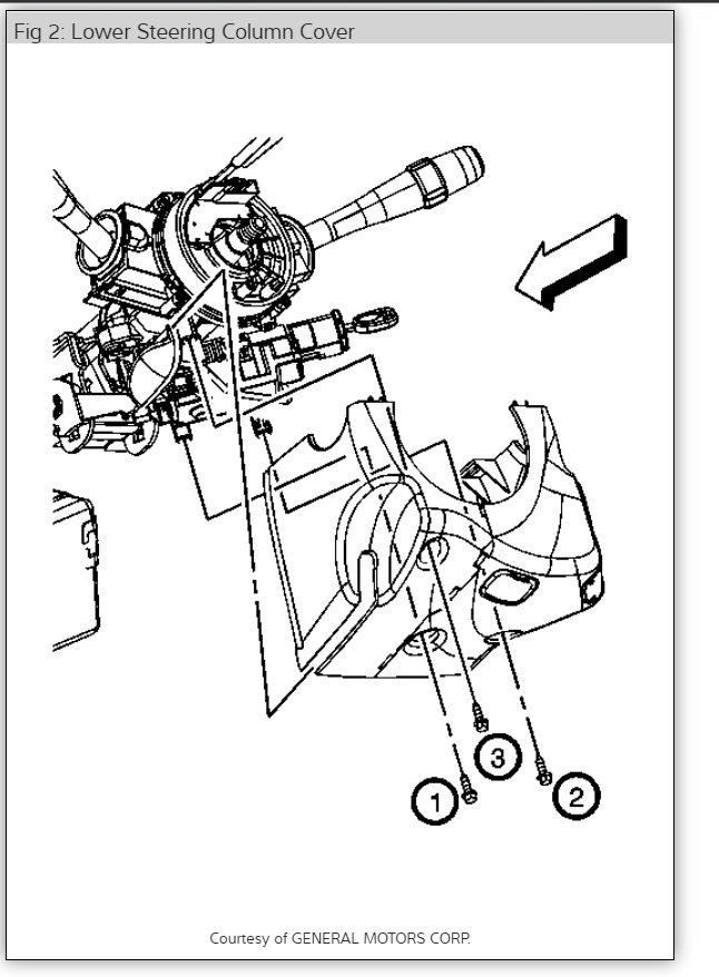

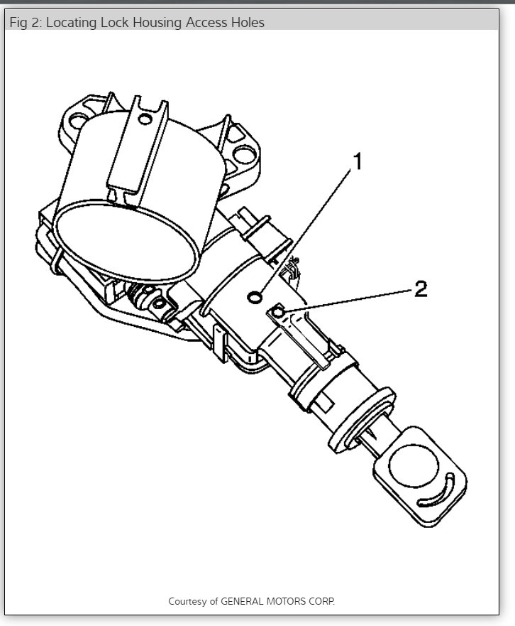

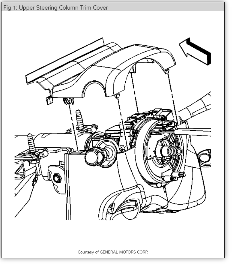

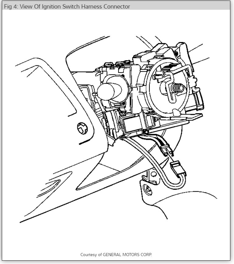

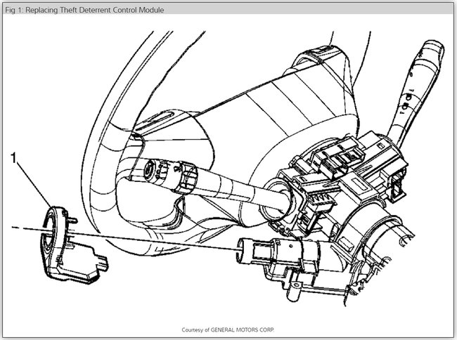

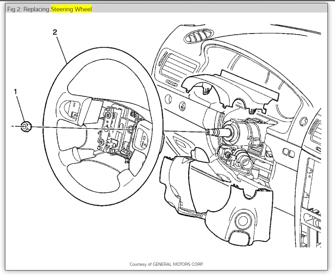

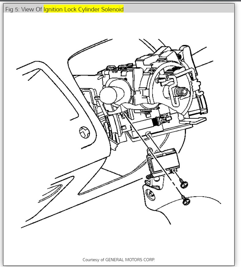

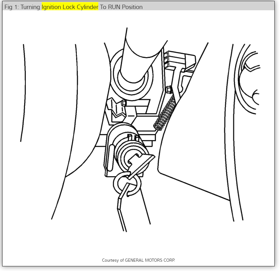

It sounds like you have an ignition switch lock assembly that is worn out. Here is a guide to show you what you are in for when changing the key lock out. You may need to have the key coded to the car before you install it the dealer can do this for you.
(Check out the diagrams below)
