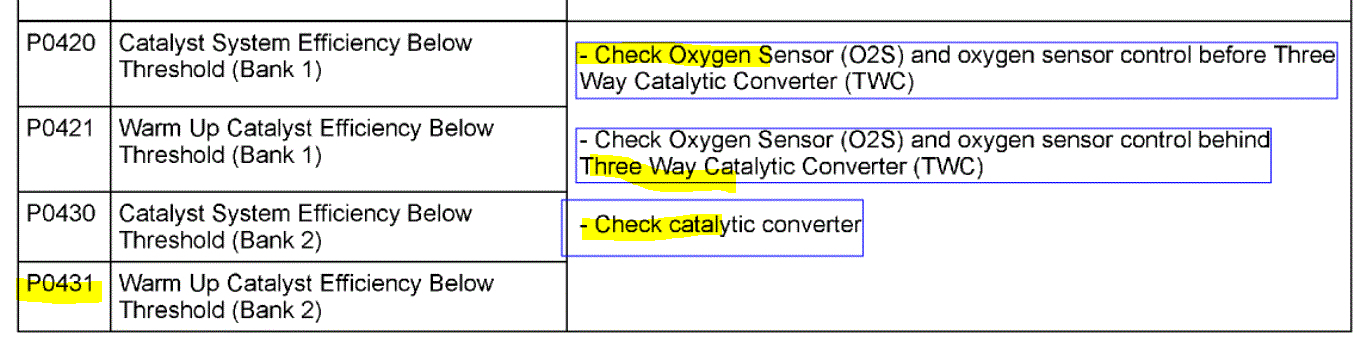

The P0456 is a small evap leak. That isn't causing the issue. The P0431 is related to the catalytic converter.
If you look at the attachment below, it indicates what to check for the P0341. It could be an O2 sensor. Here is a link that explains how to test one:
https://www.2carpros.com/articles/how-to-test-an-oxygen-sensor-02-sensor
Also, if you have a live data scan tool, watch the voltages from the sensors. It will fluctuate when working. Voltages should be between .1v and .9v. If it stays at one reading, replace the sensor.
Do this and let me know what you find.

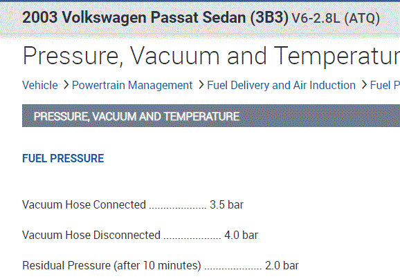

A very rich fuel mixture will cause a gray/black smoke. If the vehicle is running that rich, it will damage things and run poorly.
Since you have that issue, I need you to check the fuel pressure to see if it is within spec.
Here is a link that explains in general how it's done:
I attached the manufacturer's fuel pressure specs below.
Let me know what you find.

I read through all of our conversations. I think I may know what is happening. There is a chance you have a fuel injector leaking causing running issues and smoke from one side of the engine.
What to do is check fuel pump pressure and then fuel pressure drop off. Here is a link you may find helpful. It explains how to test fuel pressure.
When you turn the engine off, pay attention to how long it takes for the pressure to drop. t really shouldn't drop more than 5psi within the first minute.
Sep 12, 2021 at 6:54 PM
