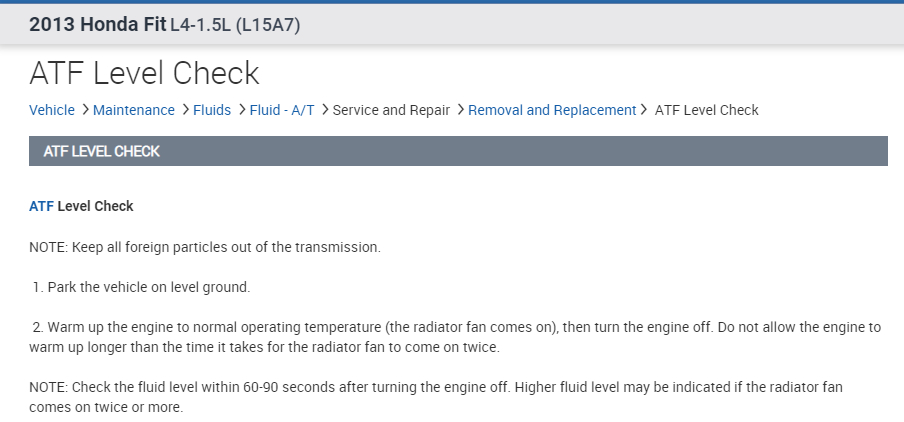

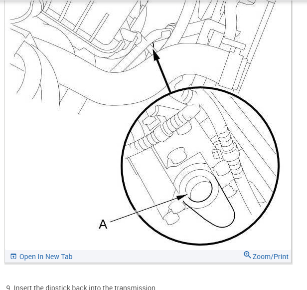

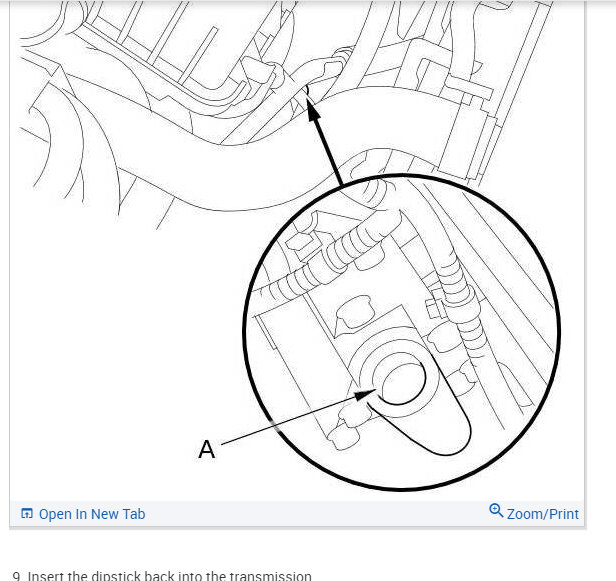

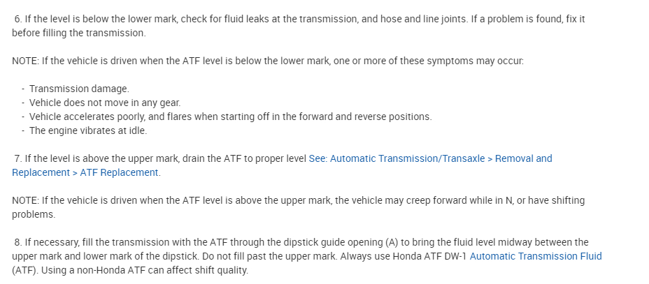

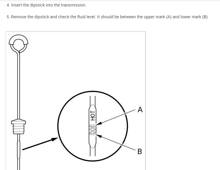

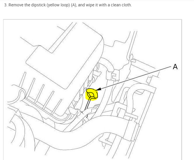

If you haven't checked the transmission fluid level and condition, I attached the directions below for you. Do this and let me know what you find.
See pics below.

I went through the two manuals and neither indicates a dual-clutch. When you serviced it, where did you add fluid?
https://www.2carpros.com/articles/how-to-check-and-add-transmission-fluid
