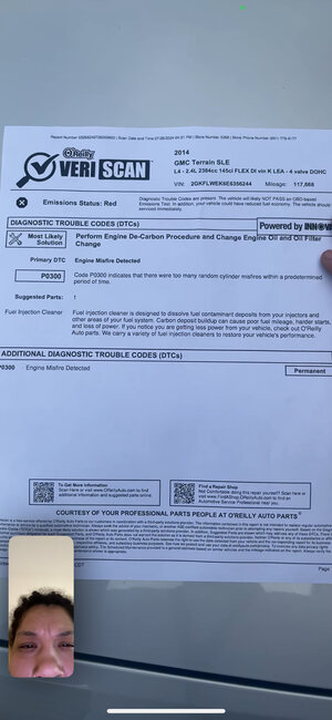

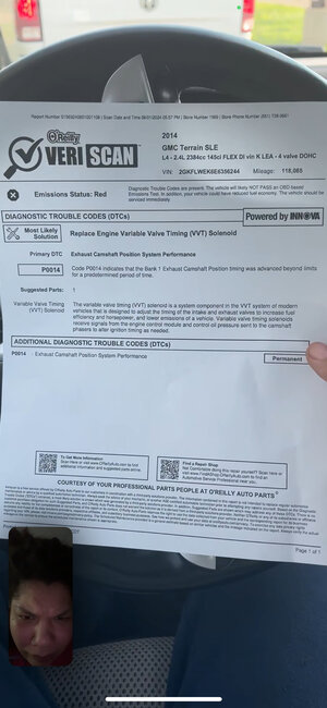

My car was throwing a P0300 code at first, and then a couple days later it threw P0014 saying that bank 1 was advanced beyond limits. The mechanic changed 1 VVT and I got my car back and about a couple days later my truck started jerking when in idle at stop signs or lights and especially did it when in eco mode. I’m posting a video of what it’s actually doing in idle. Do you know what could be the problem?

P0300 - Random/Multiple Cylinder Misfire Detected:
P0014 - "B" Camshaft Position - Timing Over-Advanced or System Performance (Bank 1):
