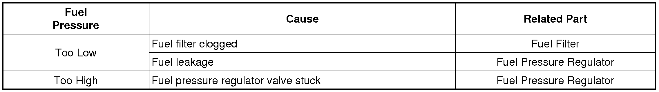

Here are the specifications for pressure. The attached pic explains the causes for variation.
2013 Hyundai Accent L4-1.6L
Pressure, Vacuum and Temperature
Vehicle Powertrain Management Fuel Delivery and Air Induction Fuel Pump Fuel Pressure Specifications Pressure, Vacuum and Temperature
PRESSURE, VACUUM AND TEMPERATURE
Fuel Pressure
Start the engine and measure the fuel pressure at idle.
Fuel Pressure: .................... 429 - 469 kPa (4.38 - 4.79 kgf/cm2, 62.3 - 68.1 psi)
NOTE: If the fuel pressure differs from the standard value, repair or replace the related part.
