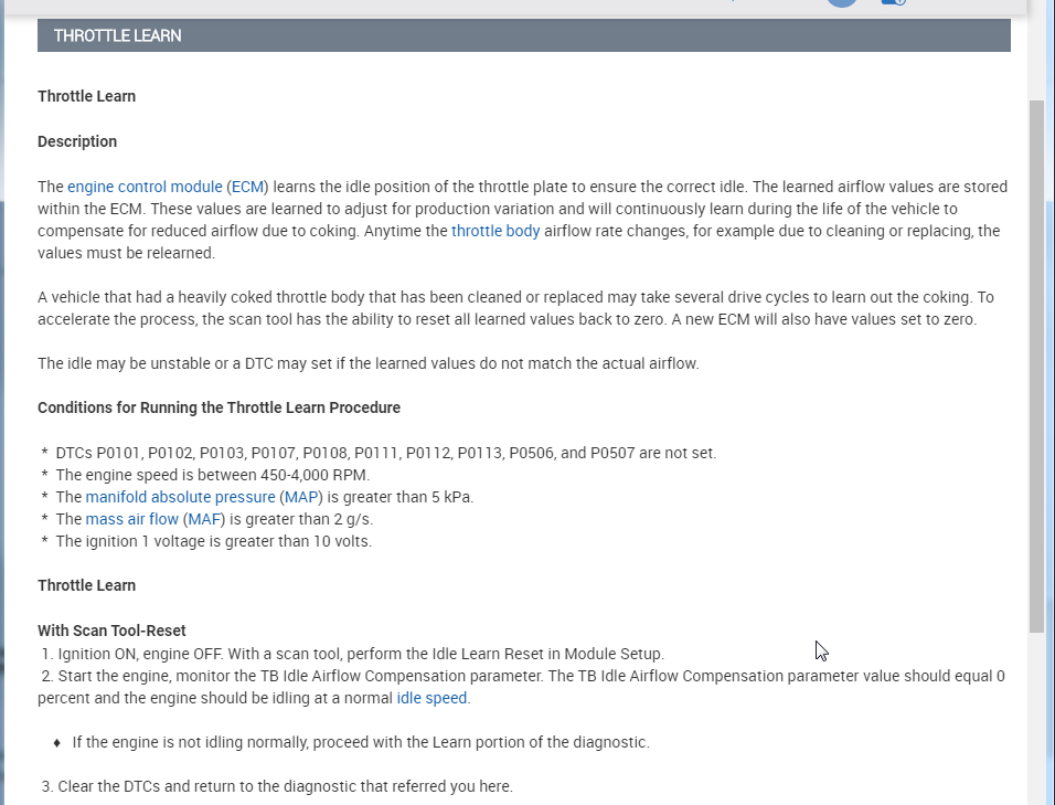

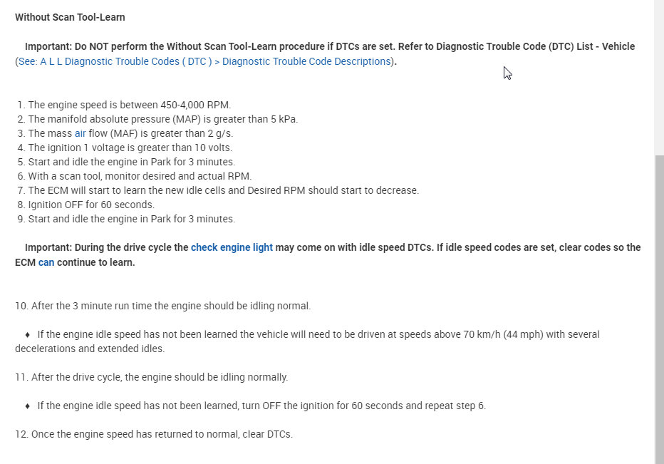

Let's check for codes first. If there are no codes then I suspect we have one of two issues. Either the throttle needs to be learned (process attached) or we have a sensor issue.
Just so I am clear, the vehicle starts and idles fine but when you put it in hear, it will act up and stall unless you get it back in park? If this is the case it is because of the load from the transmission which is most likely a sensor issue.
If there are codes let me know what they are. If no codes then try the learn process and let me know what happens.
