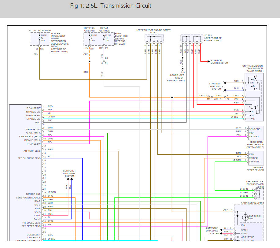

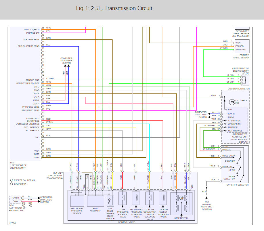

Lets check the power and grounds for the transmission. here is a guide to help and the transmission wiring diagrams below. Also check fuses 34, 11 and 4.
