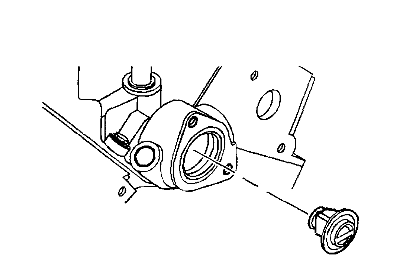

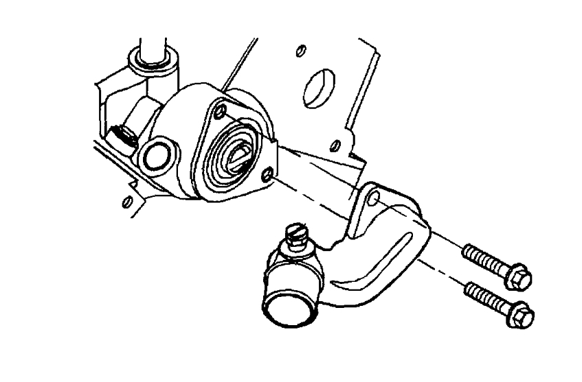

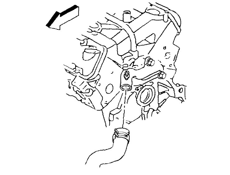

Thermostat Replacement (3.4L)

3. Use the J 38185 to reposition the hose clamp from the water outlet housing.
imageZoom/Print
4. Remove the radiator inlet hose from the water outlet housing.

6. Remove the water outlet housing bolts.
7. Remove the water outlet housing and the gasket.

8. Remove the thermostat.
9. Clean the water outlet mating surfaces.
