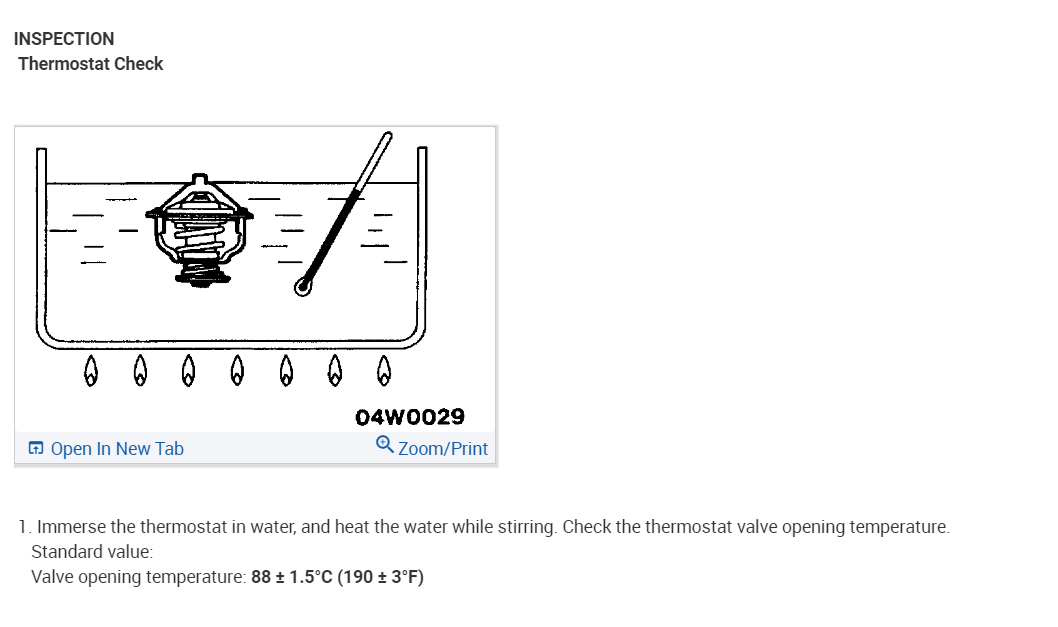

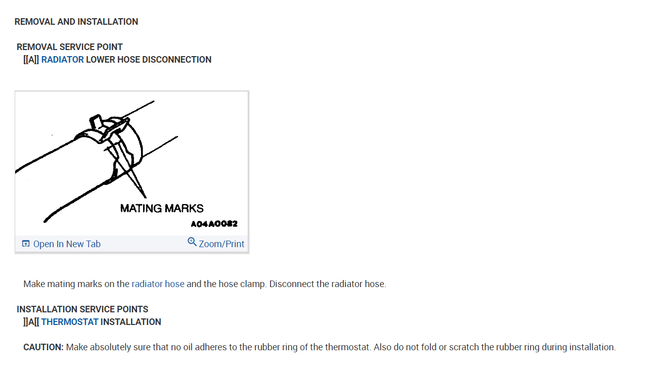

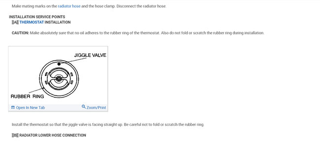

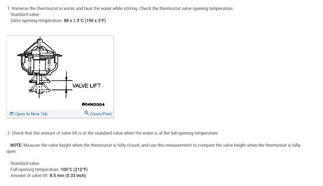

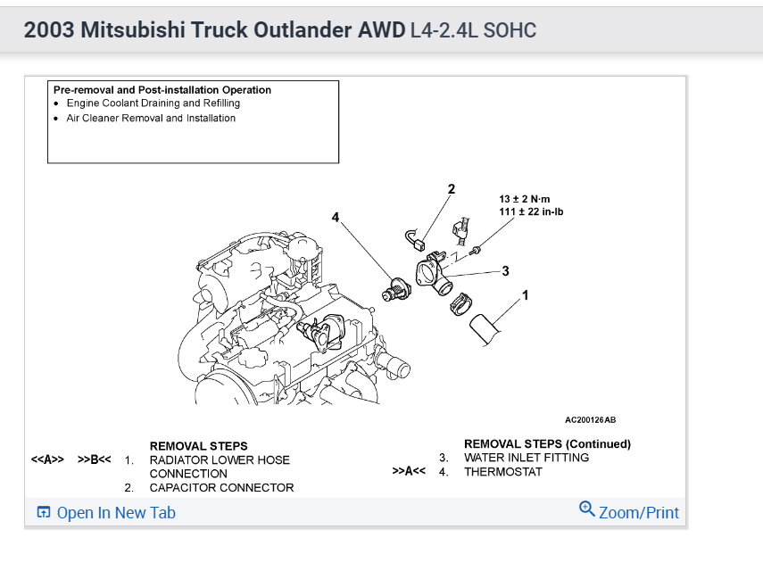

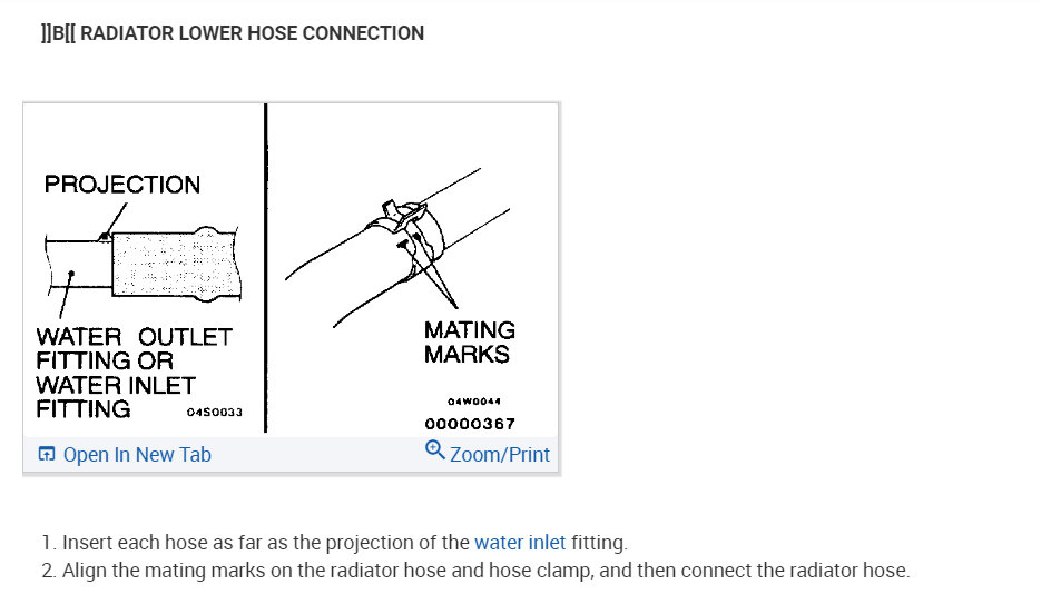

Hello there and happy new year. A week ago, I noticed that my car is cooling down when driving on down slides. It goes back to normal temperature when on level terrain or uphill. I suspect it's just a thermostat, but I wanted to ask you guys first. Also, any tips on replacing the thermostat would be appreciated. Thank you in advance.
