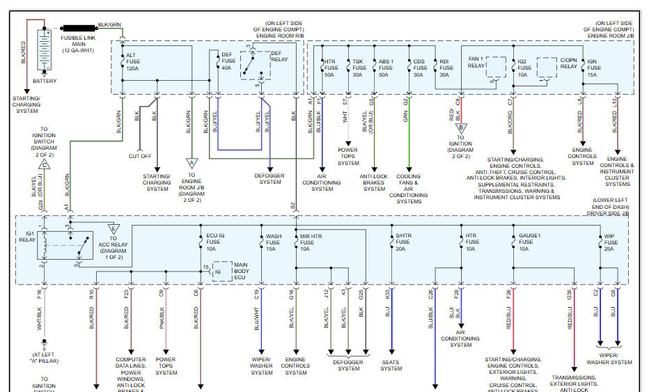

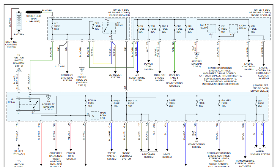

So to be clear when you press the gas pedal the engine does not have any power, or the is no 5 volt reference to the accelerator sensor in the pedal? I think we should run the codes to see if any come up. Please watch this video
https://www.youtube.com/watch?v=LBCpCWEFnTg
I would double check the fuse as well. Here are the main fuses that power the systems, please go over these again. Check out the images (below). Please let us know what happens. Ken
