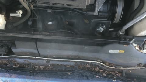

Four years later, I turned on my car for the first time since I had stopped driving it 4 years before, and it immediately started smoking white smoke like a barbecue from the area under the hood close to where the windshield wipers are, approximately in the center between the driver side and passenger side. The smoking was immediate and enormous immediately upon startup. Not after the engine gets hot, but literally instantaneously after the car is turned on. So, I turned it off within a couple of seconds.

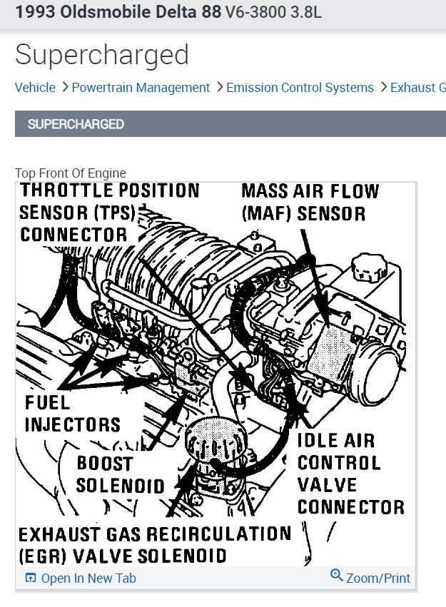

It sounds like it could be the EGR valve that is stuck open, but can you lift the hood when the engine is smoking to see where it is coming from? Valve cover, power steering line? Let us know what happens and please upload pictures or videos of the problem so we can see what's going on.
Here is the valve location and a video on how to test it:
https://youtu.be/DqUCbbKdWf4
Check out the images (below). Please let us know how it goes

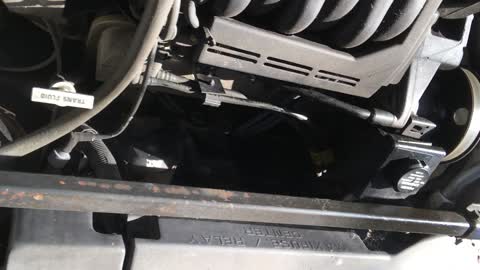

So, when you requested videos or photos, I vaguely remembered that I might have done something like that in the months leading up to the pandemic in hopes of finding a car expert to help me. So, I went and searched through my computer files, and it turns out I did make some videos back then. And watching the videos now has refreshed my memory:
In addition to the smoking like a barbecue from under the hood in the area near the windshield wiper blades, I remember now that the vehicle was also smoking like a barbecue from the tailpipe after 4 years of standing idle, though if I recall correctly, the smoke starts virtually immediately from the area under the hood, and the smoke from the tailpipe follows shortly afterwards.
Video 1 has less smoke in it than Video 2 but may help you to more precisely figure out where the smoke is coming from. I recommend watching Video 1 indoors with the screen brightness strong and the room lights down to see the smoke well, because it's more faint than Video 2.
Video 2 shows significant smoke coming from the same area under the hood between the engine and the area by the windshield wipers as Video 1. The very first time I turned on the car after 4 years, before making this video, the smoke was even more intense than in this video, literally looking like a barbecue that easily could be seen from 100 ft away.

Having watched these videos, do you still believe the EGR valve is involved? Using the diagram you provided, I lifted the hood, and the EGR valve solenoid appears to be quite a distance away (is the EGR valve under the EGR valve solenoid in the diagram you provided?) Or could the EGR valve have something to do with the original problem -- the needing to hit the gas repeatedly just to get it up to 20 mph or 30 mph before hitting cruise control -- before the car was then left idle for 4 years?

Based on these videos, is it still important to do the EGR valve test?(As noted above, I'm not 100% sure of the location of the EGR valve itself relative to the EGR valve solenoid in the diagram, and the video also mentions that they first removed the intake manifold to provide a better view, but is there any video that would show how to first remove the intake manifold on this model or similar GM car?)

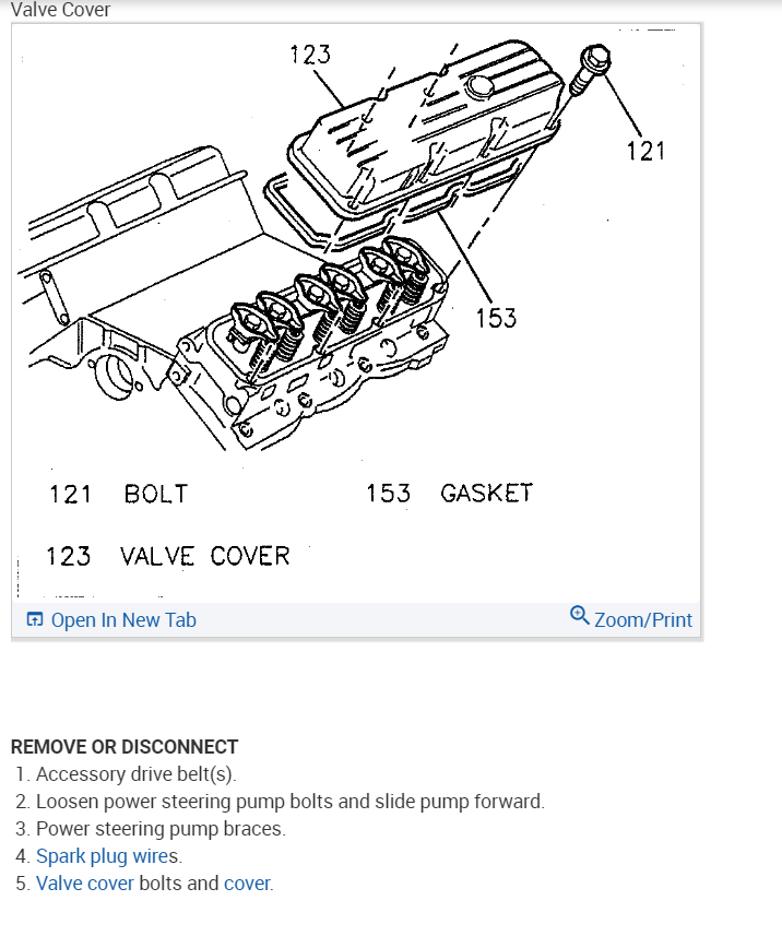

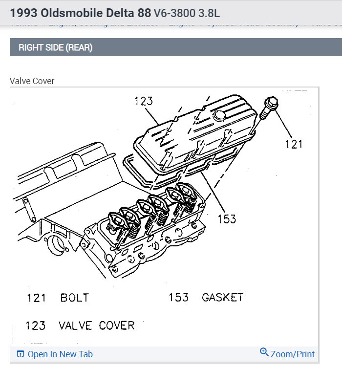

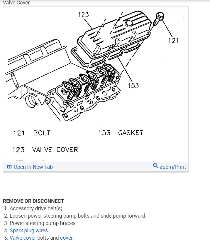

Thanks for the videos. This is because the valve cover is leaking. Here is a generic guide to help you step by step with instructions in the diagrams below to show you how on your car. I would not wash the engine, just replace the gasket.
https://www.2carpros.com/articles/replace-valve-cover-gasket

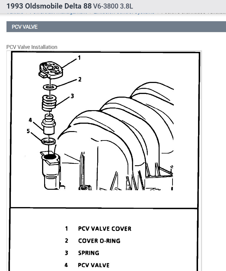

After the repair the oil will take some time to burn off, then you should be okay. The oil from the tailpipe is because the engine is worn out or the PCV valve is stuck open. Please go over this guide:
https://www.2carpros.com/articles/blue-smoke-from-engines-exhaust
