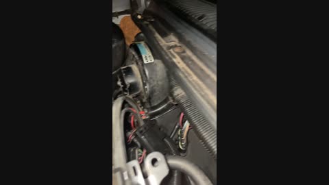

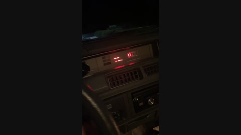

I’ve replaced the alternator on this car twice and hasn’t fixed any of my issues with starting it. I unplugged the alternator and tried starting the car and it ran (very poorly) it idled smooth but shut off when you push down on the gas all the way. It would stay on without stalling otherwise. Why won’t the car start with the alternator plugged in? I’ll attach two videos one with alternator plugged in (top) and one without (bottom).

Shuts off immediately if that wire is plugged in.

Try this and let us know what happens: Put a battery charger on the battery and let it charge fully, then start the engine and plug in the connector. From the description you say it will start and idle but poorly. The 2.8 was never a powerhouse and I think the issue might be that the battery is low enough that as soon as the alternator kick on and tries to charge the battery at a high output it is enough of a load that the engine stalls. Another version of the test would be to remove the drive belt from the alternator and see if it starts then with the alternator plugged in. If it does in either test then it's probably the load on the engine and getting the engine sorted out would probably repair it.
