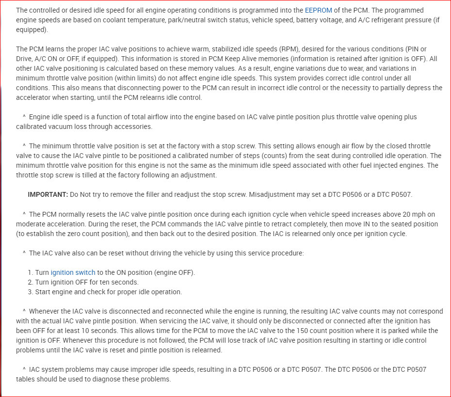

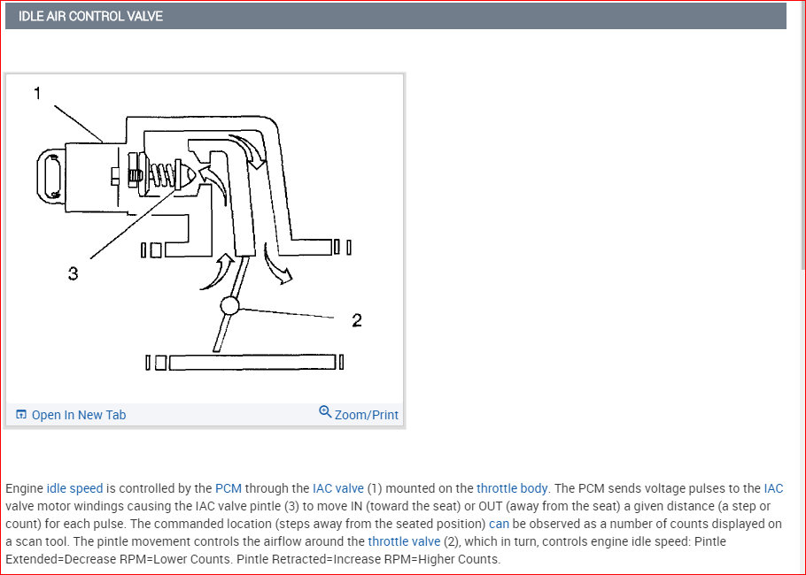

While it could be an idle air control valve as you stated, I would shy away from this simply because you said it is just fine at idle. This is what the IAC does, is control the air/fuel during idle. I attached the description of an IAC to help explain what it does.
