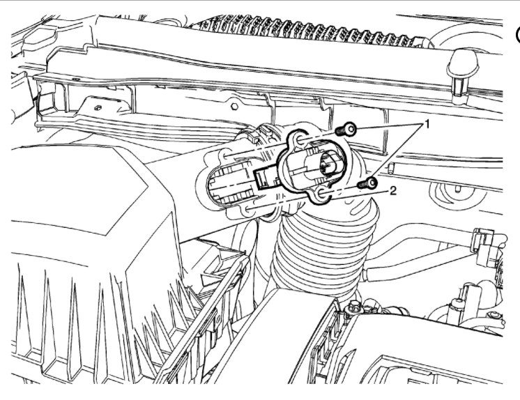

Nice work,
Those are MAF codes which will cause the problem are are describing. Here is a guide and a diagram on how the get the job done.
https://www.2carpros.com/articles/how-to-replace-a-mass-air-flow-sensor-maf
Here is some diagrams on your car (below)
