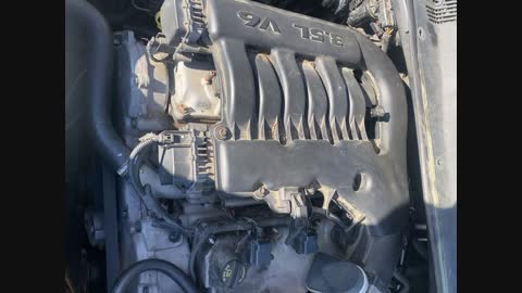

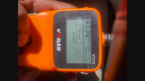

This is with my car running these other codes popped up. i started my car and it took a little while before it started when it did it idle at 1,100 for a but then dropped down to around 600 700 and keeps going down and up.
Mar 30, 2024 at 8:35 AM
Yep, low compression can cause all of these symptoms, even though your engine is a non-interference it still could have touched the valve, so a compression test is where we need to begin. There is a chance the timing belt was not installed correctly but let's do this one step at a time. Thanks for the video. If you can upload one from under the hood of the engine idling, I can tell if the engine is hurt or not.
Mar 30, 2024 at 11:13 AM
GABETOFYE222
  • 20 POSTS
Here is the video of my car idle.
Mar 30, 2024 at 3:03 PM
Thanks for the video. yep, it sounds hurt to me. I would do the compression test to confirm. Let me know the readings please.
Mar 31, 2024 at 6:34 PM
