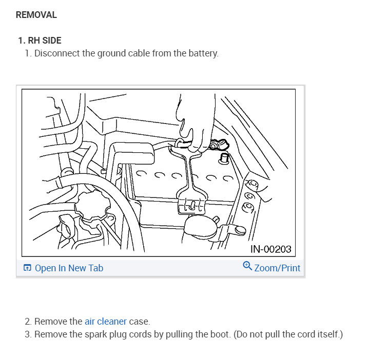

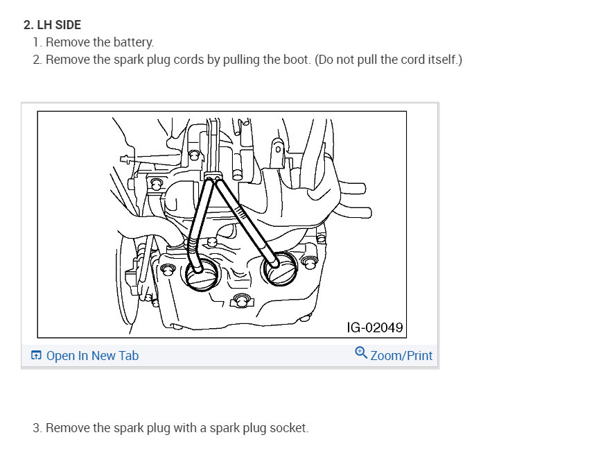

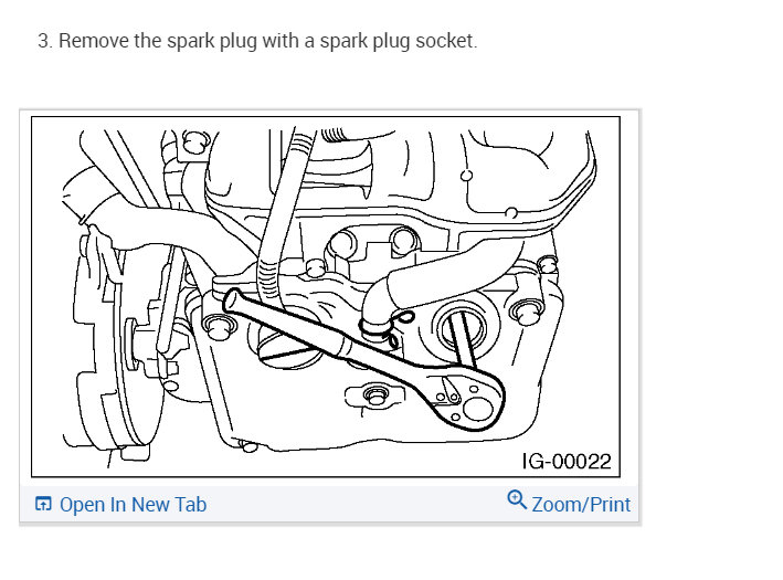

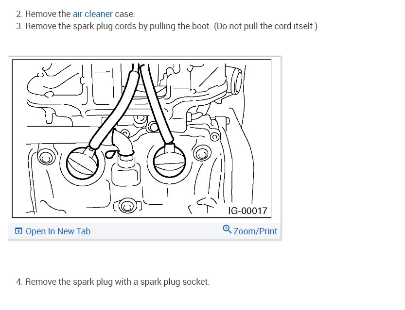

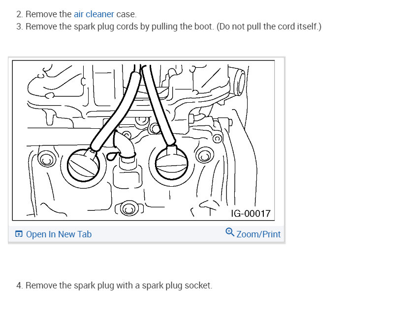

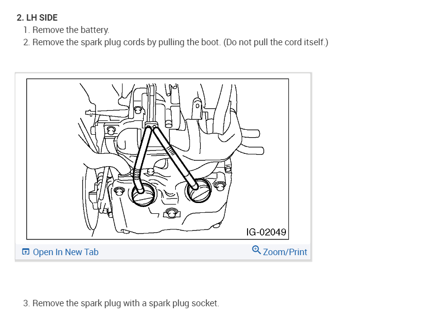

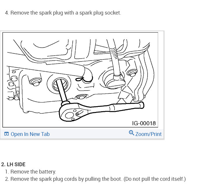

This will tell you which cylinder is having the issue. I have also included how to change out the spark plugs in the diagrams below.
Manufacturer and type .................... NGK: FR5AP-11
Thread size (diameter, pitch, length) mm .................... 14, 1.25, 19
Spark plug gap mm (in) .................... 1.0 - 1.1 (0.039 - 0.043)
Electrode .................... Platinum
