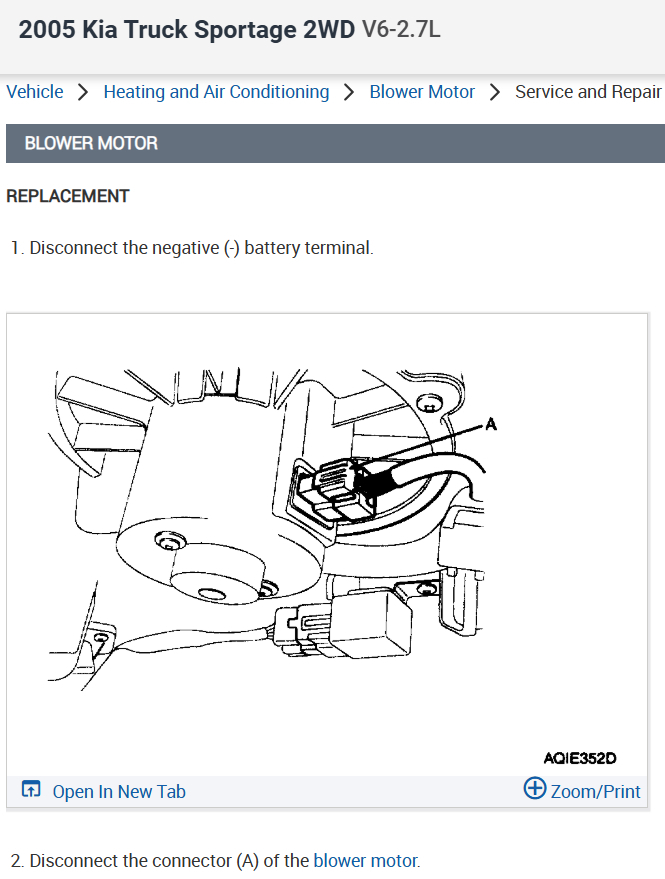

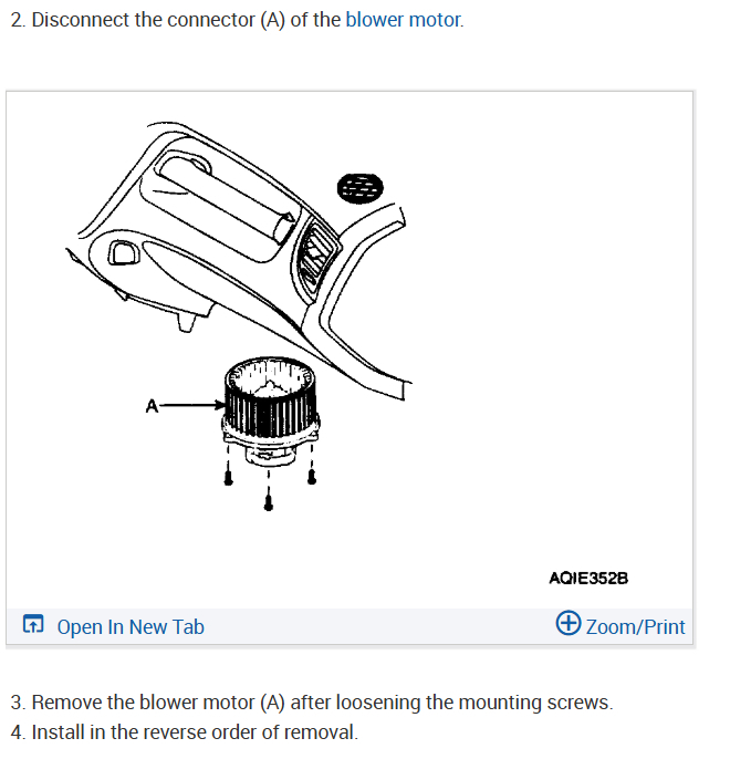

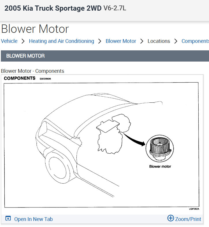

Can you tell me if you can hear the blower motor working or when the HVAC system is on there is no noise? If there is no noise, you could have a blower motor that is not working. This guide can help you test the system; you can just have a blower motor that has gone out, which is common.
https://www.2carpros.com/articles/how-to-test-an-automotive-hvac-system-blower-fan-motor-a-detailed
Also, does the blower not work in all speed positions? Check out the images (below). Please upload videos in your response of any problems so we can see what to help you with.
