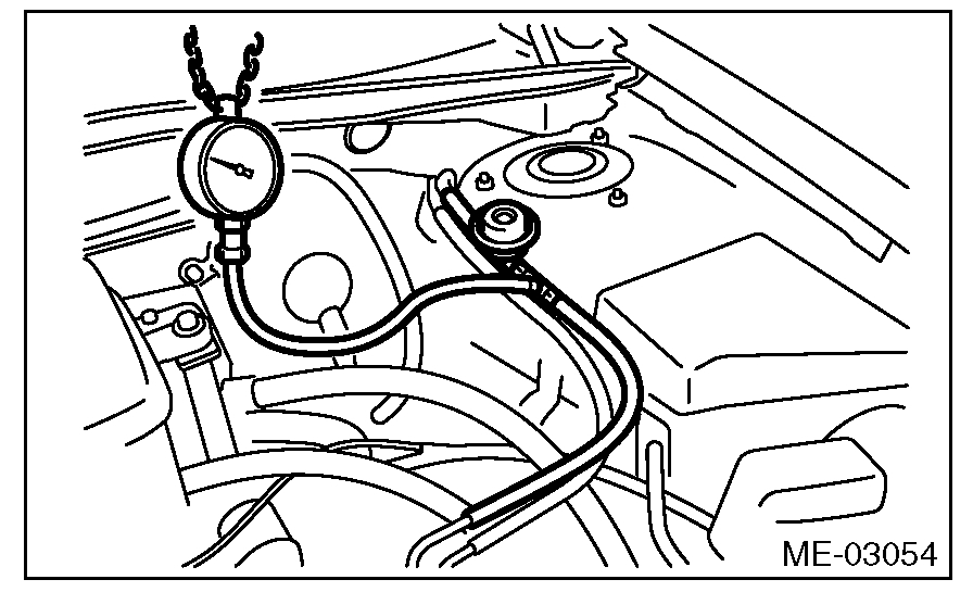

Next, if the ECT is correct, then I would confirm fuel pressure isn't weak. Here is a link that explains how to test it:
Here are the directions specific to your vehicle. The specs are included in the directions and picture 1 correlates with the directions.

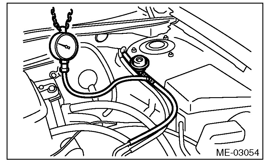

3) Disconnect the fuel delivery hose from the fuel damper, and connect the fuel pressure gauge.
pic 1
4) Start the engine.
5) Measure the fuel pressure after warming up the engine.

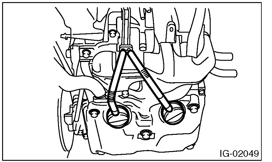

1. RH SIDE

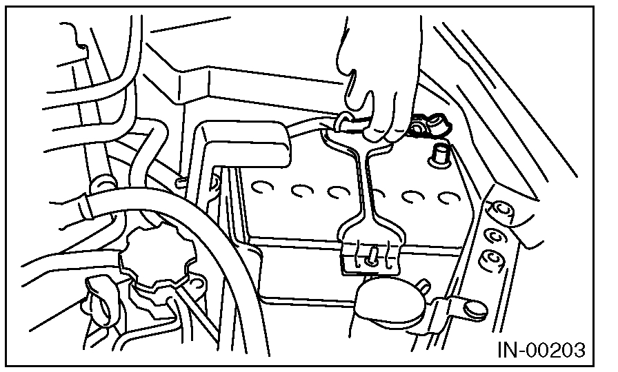

1. Disconnect the ground cable from the battery.
pic 2

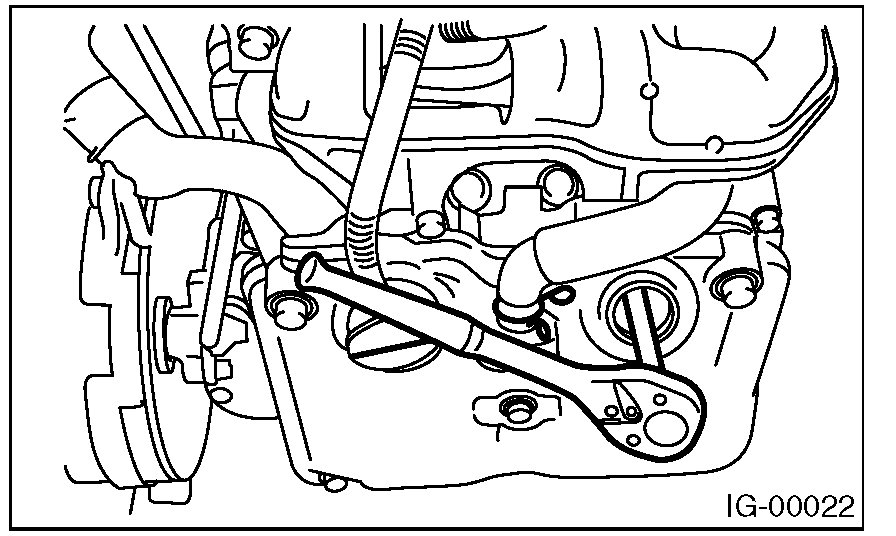

2. Remove the air cleaner case.

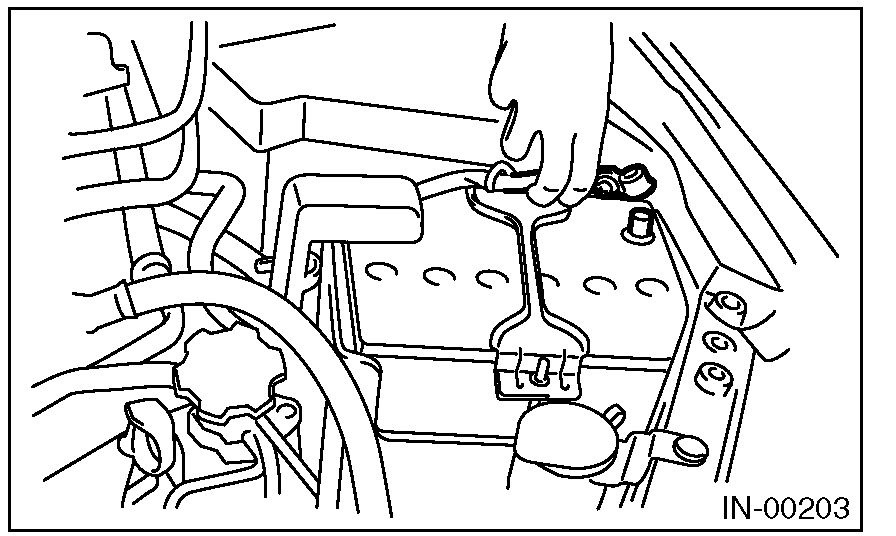

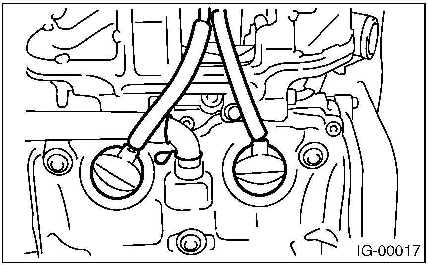

3. Remove the spark plug cords by pulling the boot. (Do not pull the cord itself.)
pic 3
4. Remove the spark plug with a spark plug socket.
pic 4

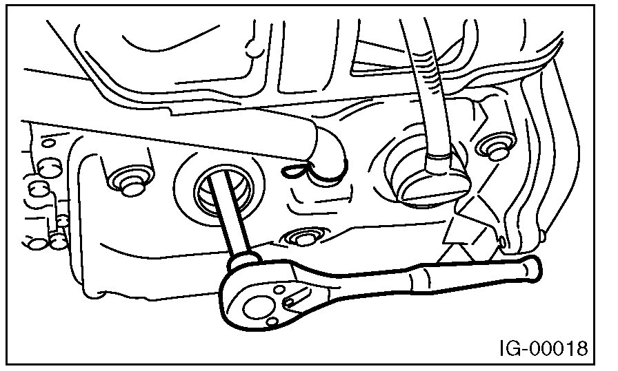

3. Remove the spark plug with a spark plug socket.
pic 6

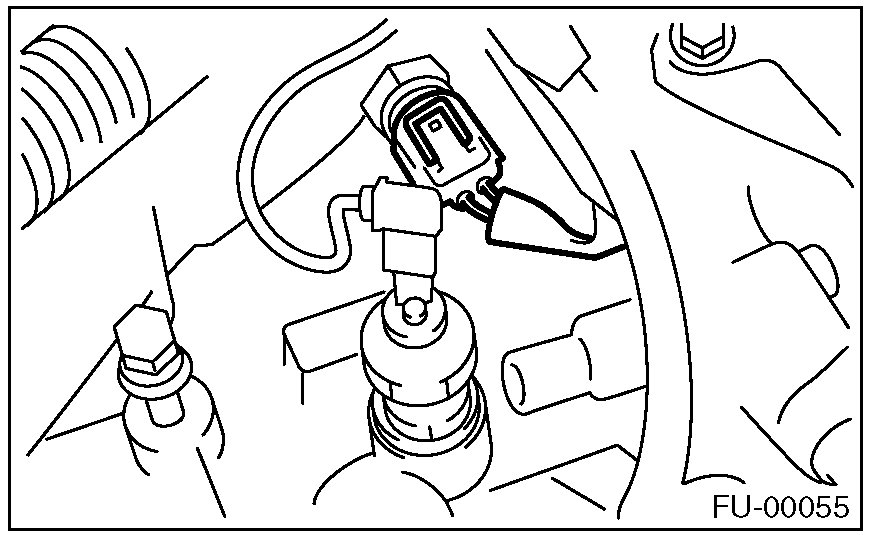

4. Disconnect the connectors from the engine coolant temperature sensor.
pic 8
