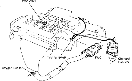

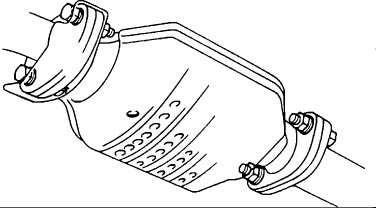

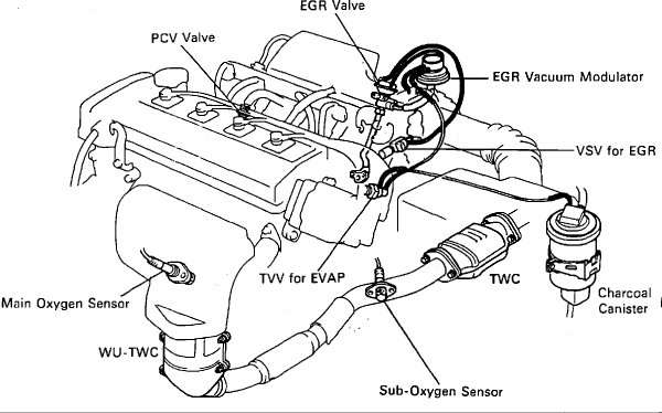

I attached three pictures of the converter and its location. Note: The first one is for federal emissions and the second one is for California. I am not sure where you live.
The third picture is that of the converter in your vehicle.
Give this a check and let me know what you find.

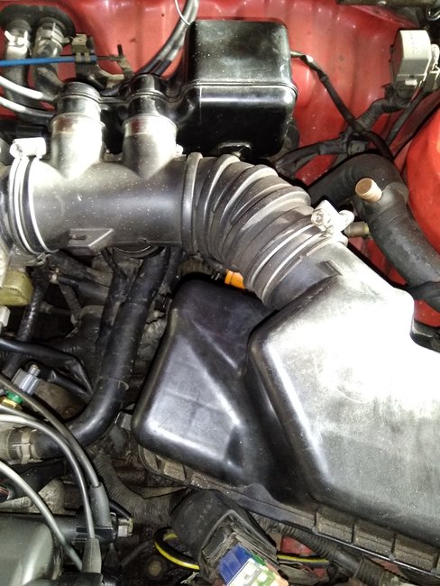

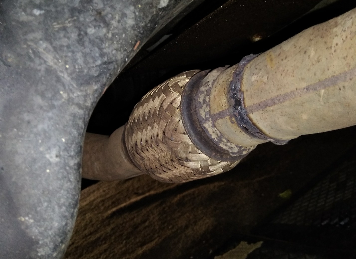

My car does not have the converter or sensor switch, only 2xsilencer boxes.

Welcome back. The picture you attached is the flex pipe. The vehicle was manufactured with a catalytic converter. If you purchased the vehicle new, I am confused. However, if you purchased it used, it appears someone removed it. Ugh, that leads to new issues. For example, there should be an oxygen sensor which is most likely missing.
Did this problem start all at once? Honestly, without the sensor and converter, the computer most likely does not know what to make the fuel mixture.

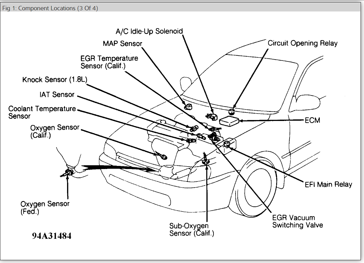

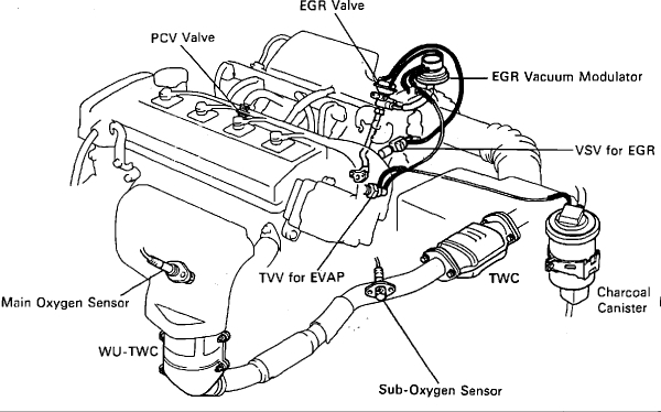

No, the shaft is a straight shot. It sounds like to me the engine coolant temperature sensor is not working right when the engine gets hot.
Here is a guide to help you see what you are in for when doing the job:
https://www.2carpros.com/articles/coolant-temperature-sensor-cts-replacement
Here is the location for your car. Check out the diagrams (below). Please let us know what happens.
