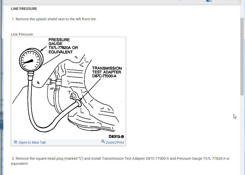

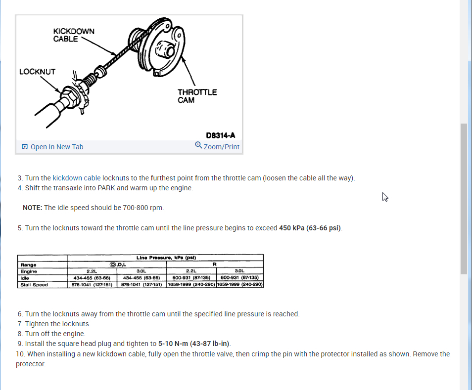

I put the car into any gear and it doesn't move. The car knows what gear its in because the reverse lights still come on and I can hear the engine rpm change when I shift it. The transmission that came with the car had this problem so I swapped one that is supposed to be working into the car and it has the exact same problem. There is plenty of fluid in the transmission and no fluid comes out of the transmission cooling lines. The fluid still heats up inside the transmission. Just wondering what else could be a contributing factor.
