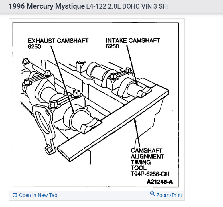

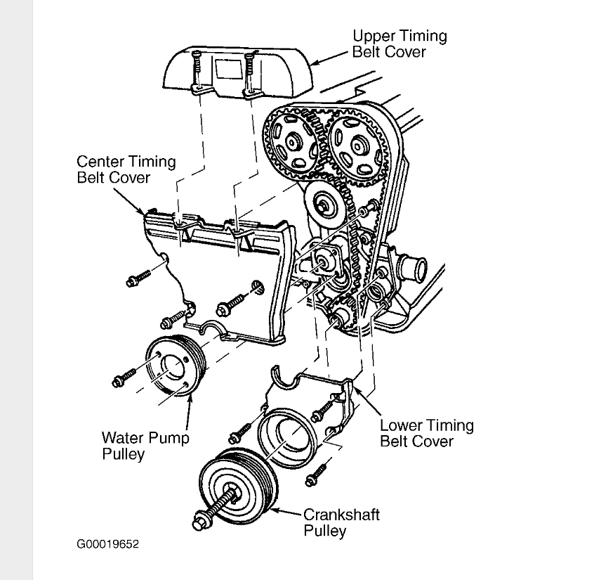

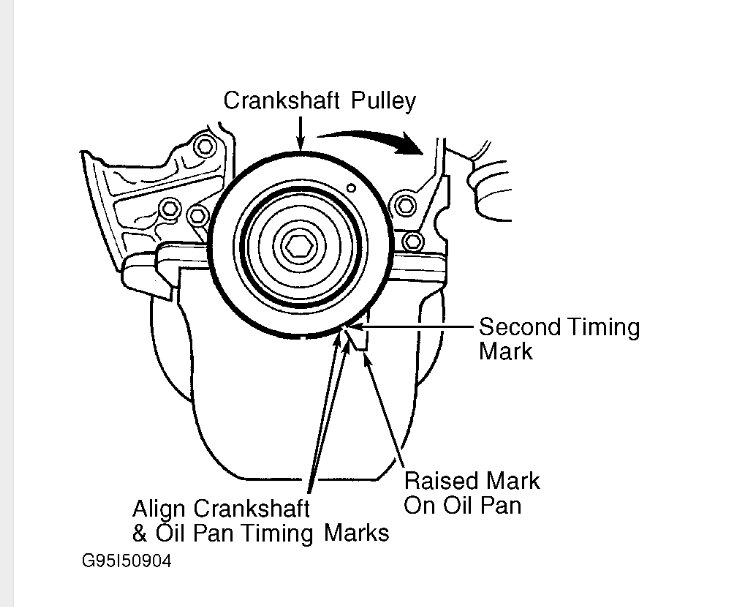

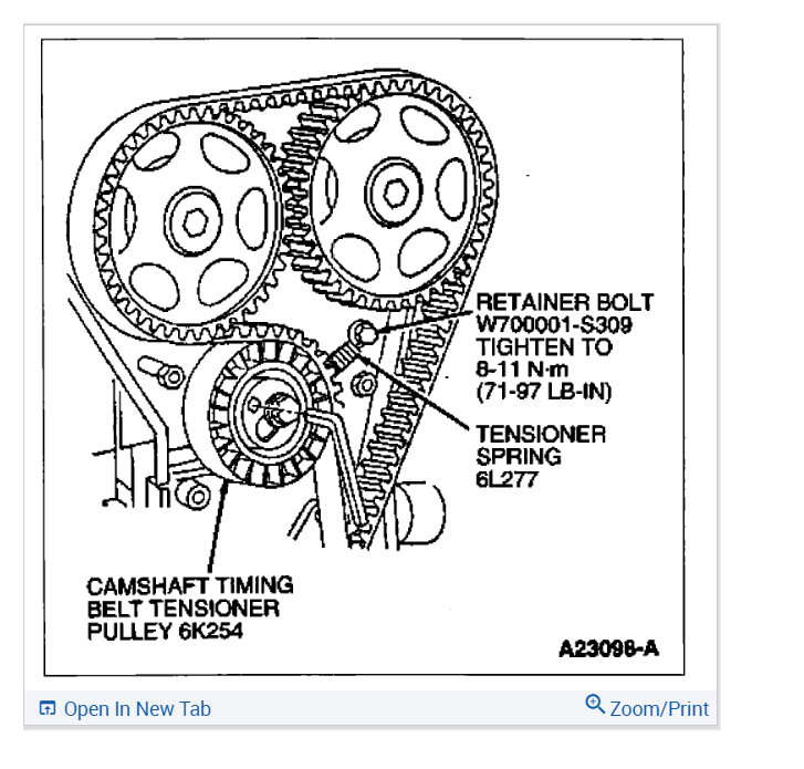

If the timing belt was loose the engine could have jumped time so when you sprayed starting fluid it ignited inside the intake causing the damage, you have described. I would recheck the timing belt marks which I have included in the images below. Also, if you can upload an image of the airbox I can help you determine if it can be repaired. Check out the images (below). Please let us know what happens.

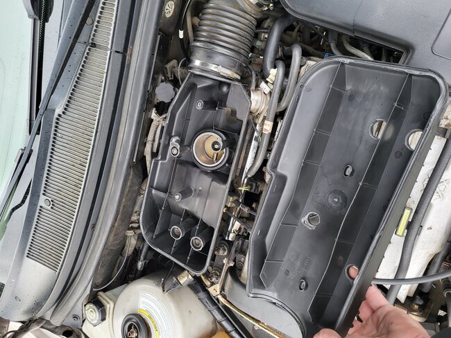

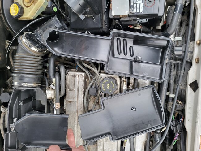

It broke pretty clean.
Mar 23, 2023 at 5:50 PM
Yep, that came apart pretty good, I would try some epoxy to glue it back together make sure there are no holes and that the part is airtight. Also any luck with the timing belt?

Haven't spoken with him but last he said it wasn't the timing belt. It was nice and tight. Could replacing the camshaft or crankshaft be a solution to the non-starting? I've glued it back together but nervous to try to start it after last time.

Would you recommend permatex plastic, jb weld or goop automotive for glue to use? I was trying to get input ahead of time and am just now actually trying to get her up and running. Can I crank it for the video without the airbox crap assembled?
Apr 7, 2023 at 6:15 PM
Yes, you can, I have had good luck with JB weld.
