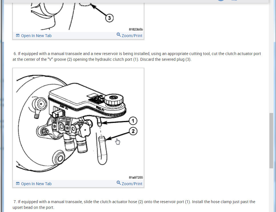

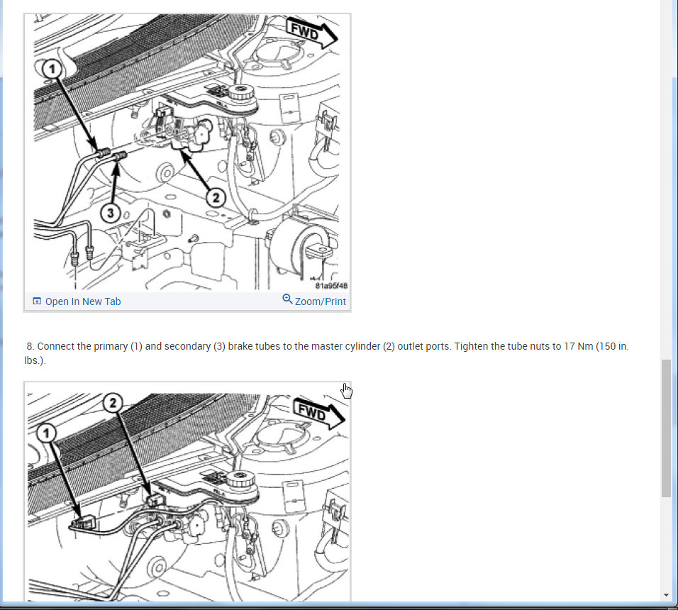

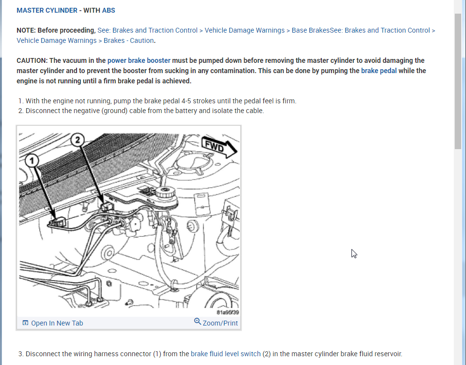

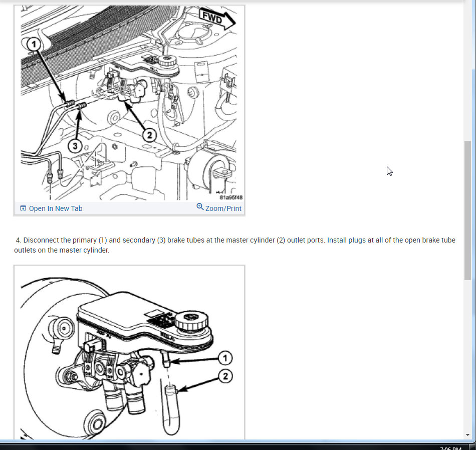

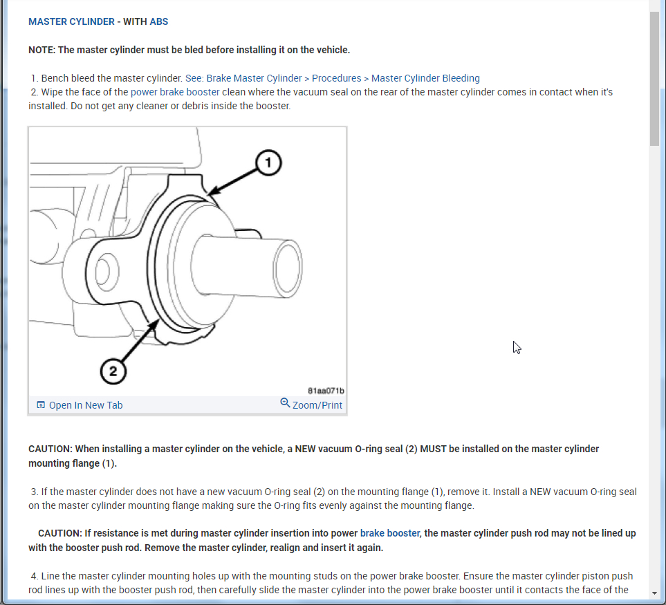

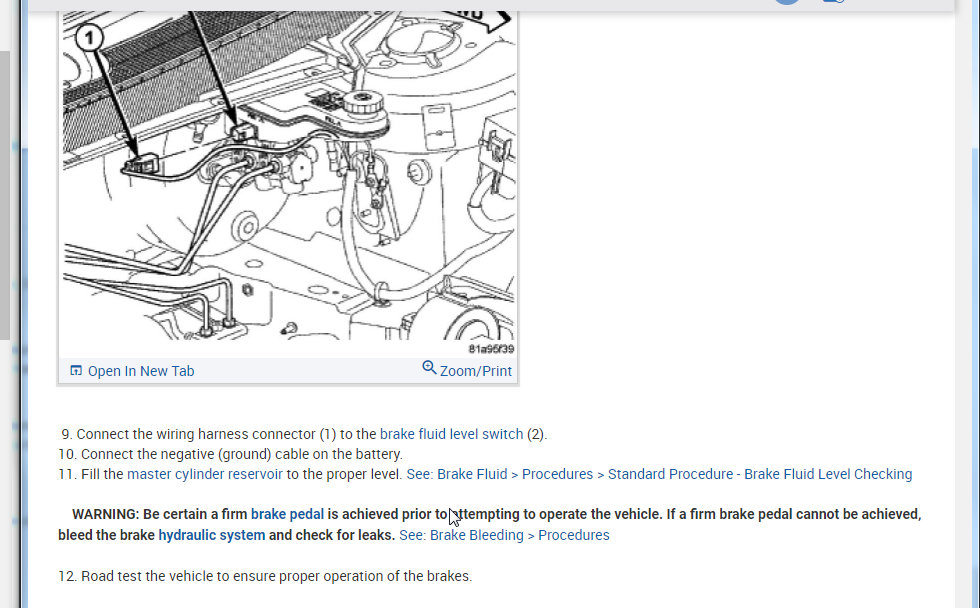

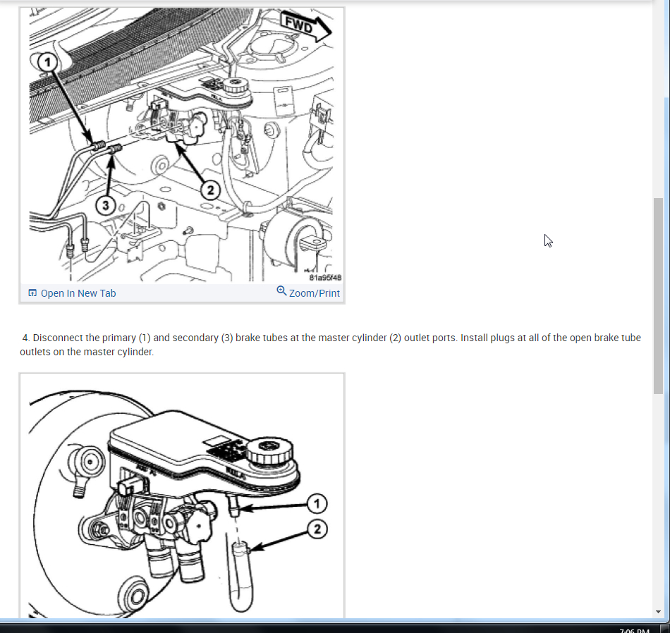

Here is a guide that will help with this:
https://www.2carpros.com/articles/how-to-replace-a-brake-master-cylinder
Below is the process from the manual on how to replace the master.
Please let us know if you have other questions. Thanks
