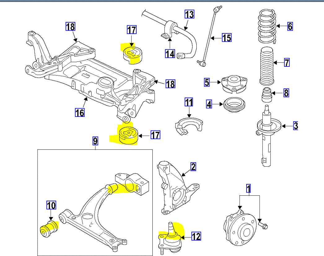

The idea that you feel it on acceleration leads me to believe it could be a control arm issue, a ball joint, or stabilizer issue. It could even be related to the subframe bushings.
I attached an exploded view of the front suspension. Check the items I highlighted for play. As far as the CV joint, it has to have a small amount of in and out play.
