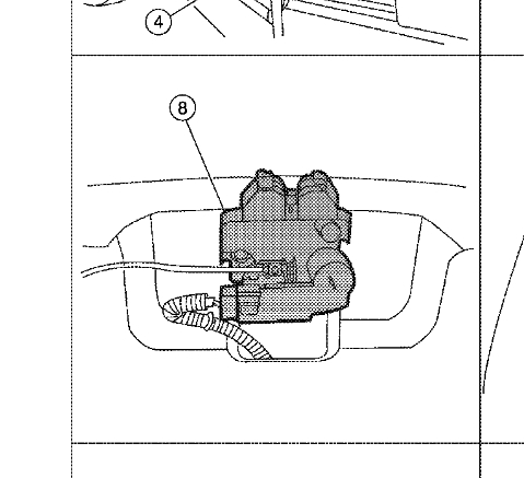

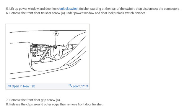

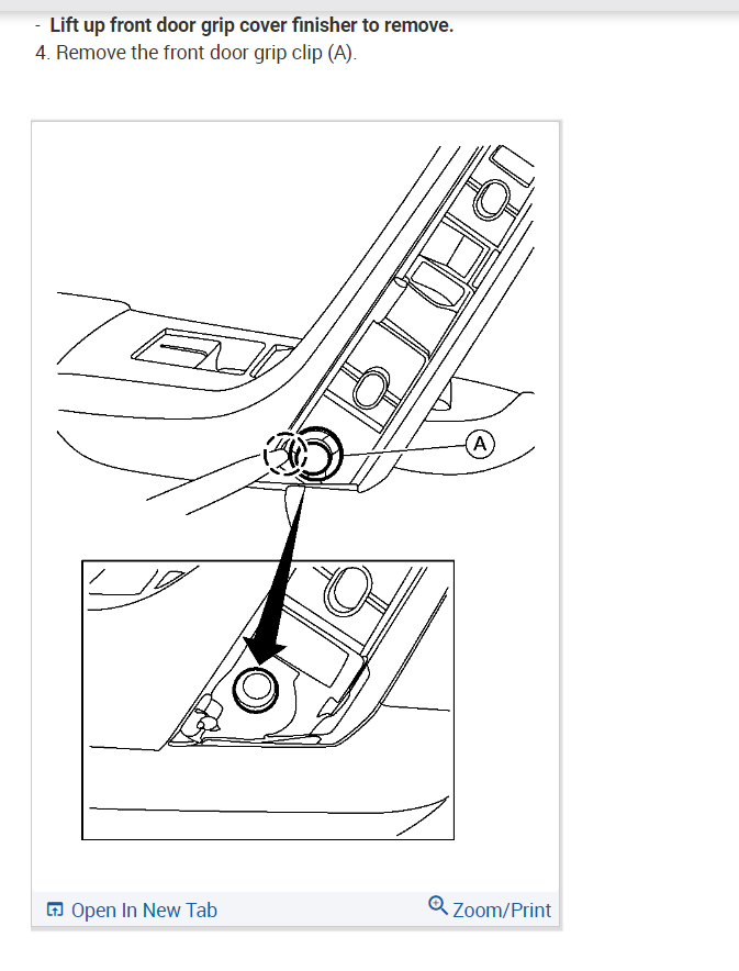

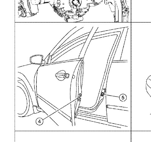

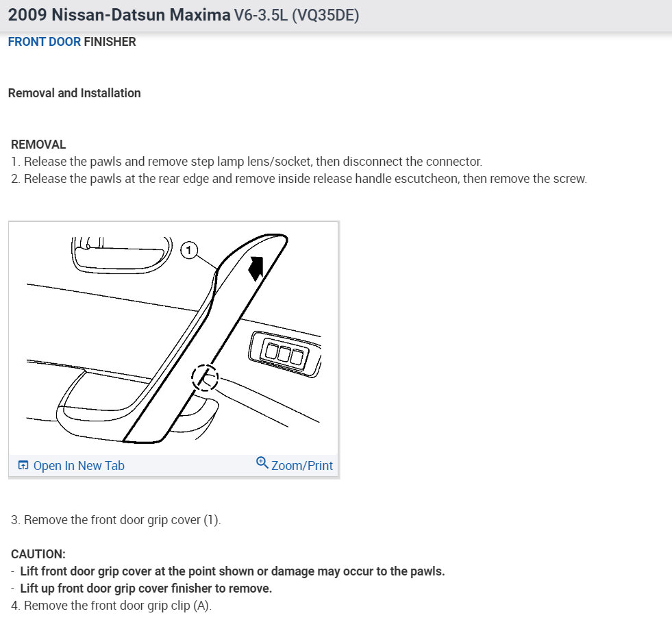

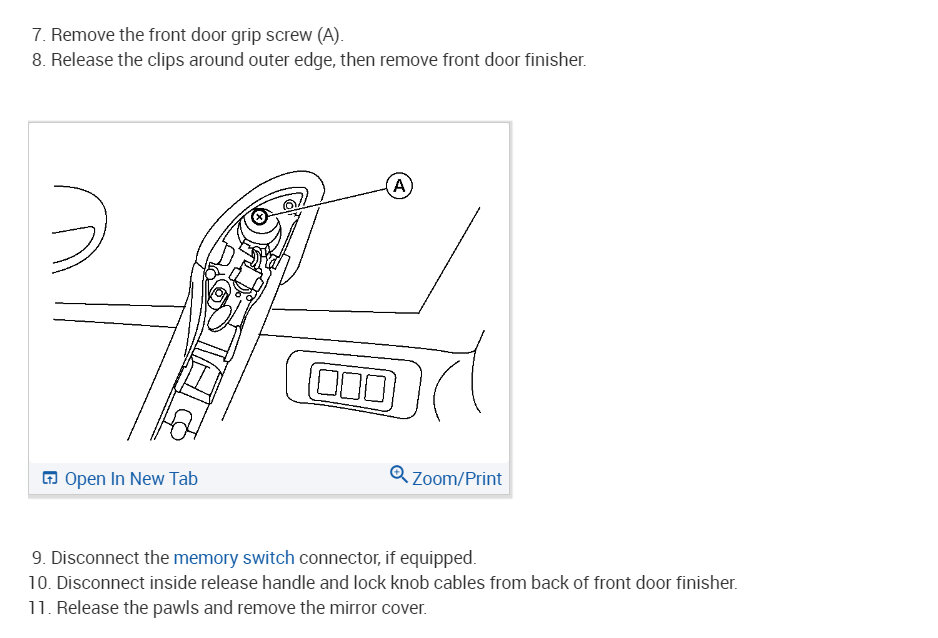

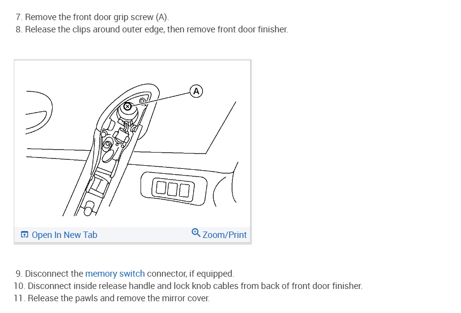

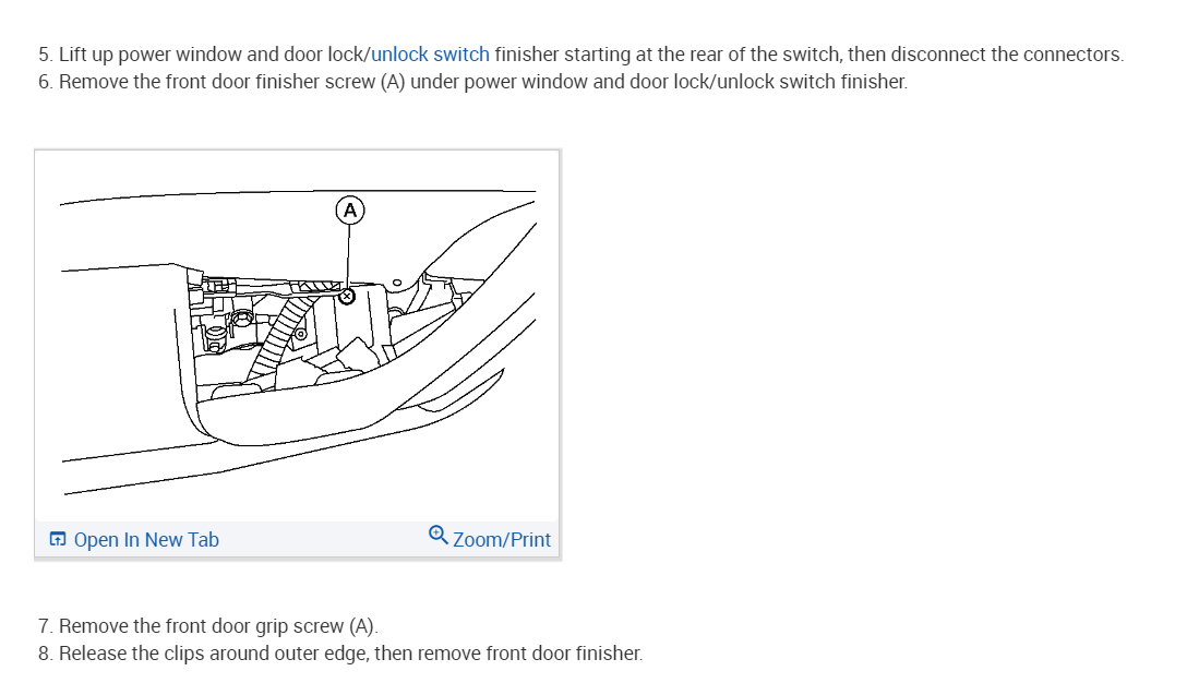

I would try to remove the inner door panels to see if the lock rods have fallen off the door latches, it just seems strange they would do this at the same time. You will need to remove the front seats to get at the panels. Check out the images (below). Let us know what happens and please upload pictures or videos of the problem.
