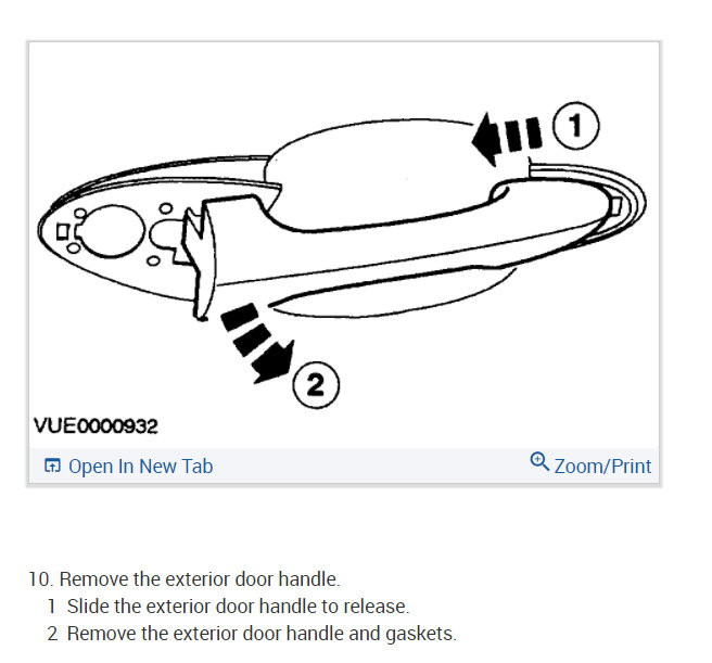

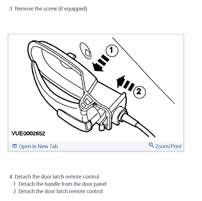

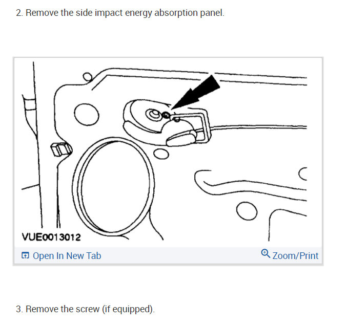

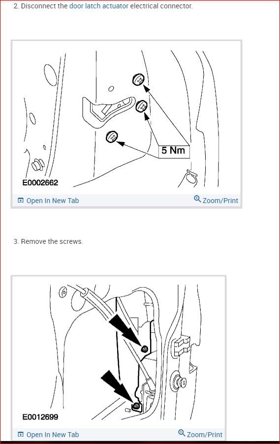

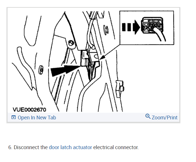

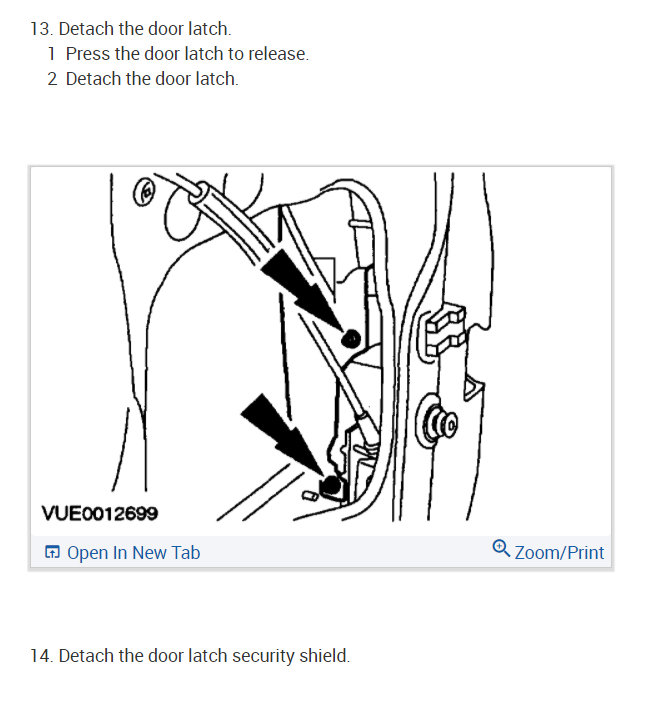

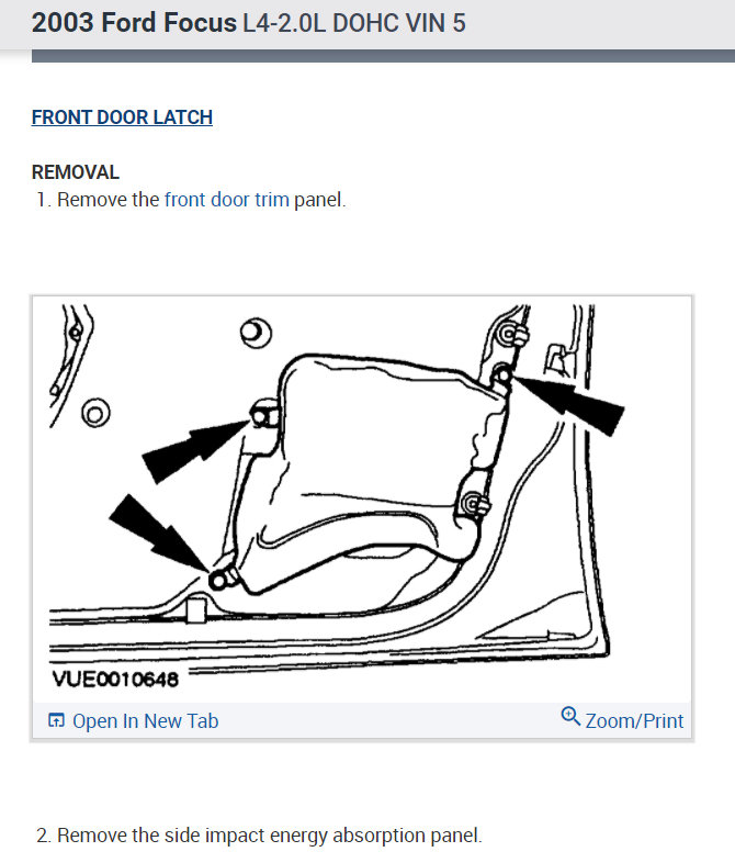

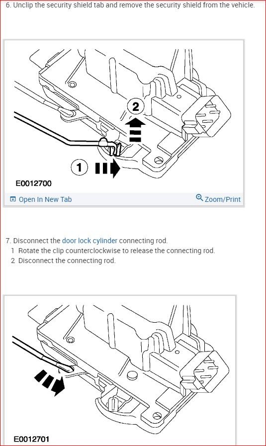

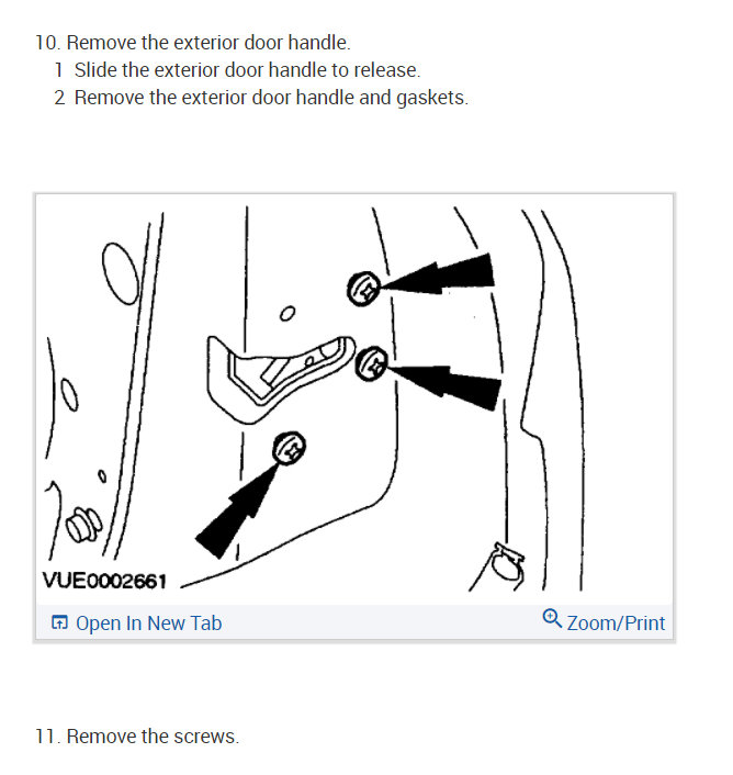

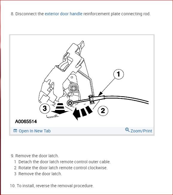

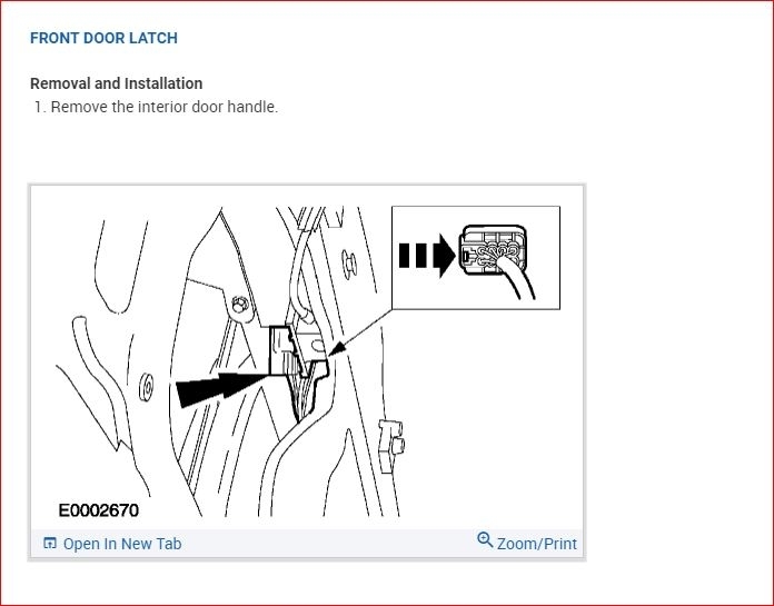

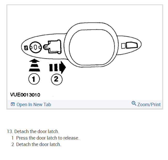

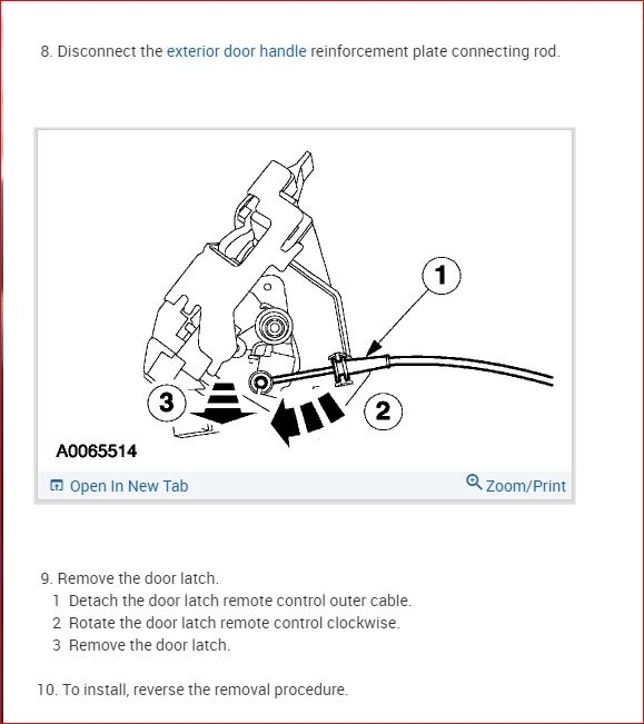

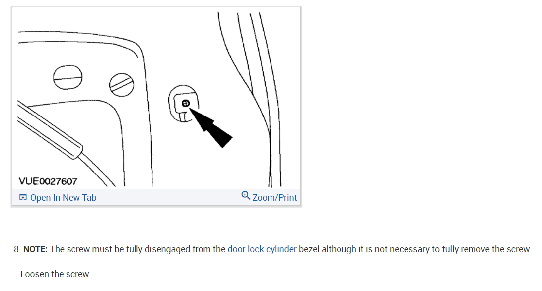

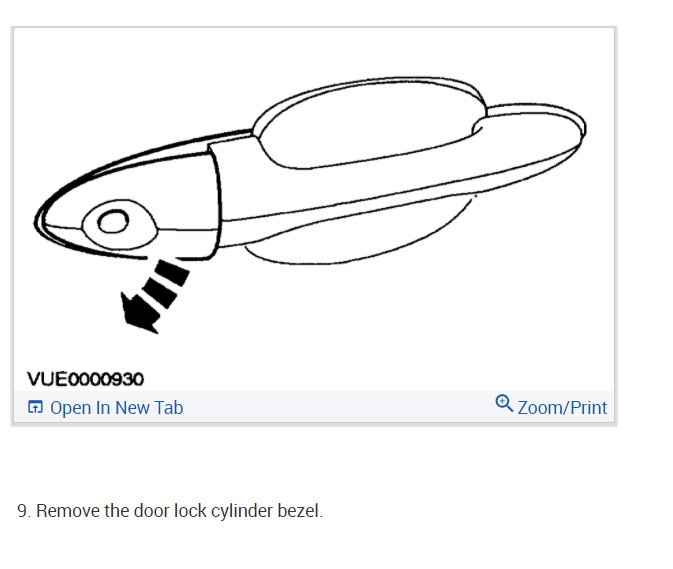

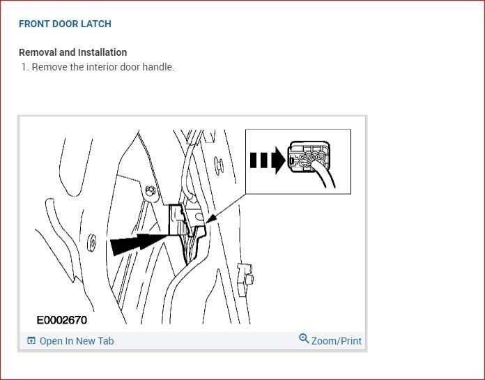

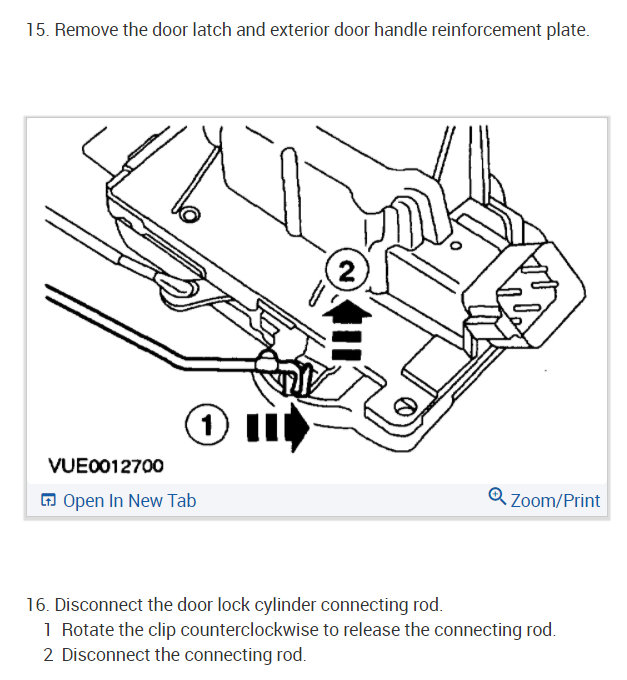

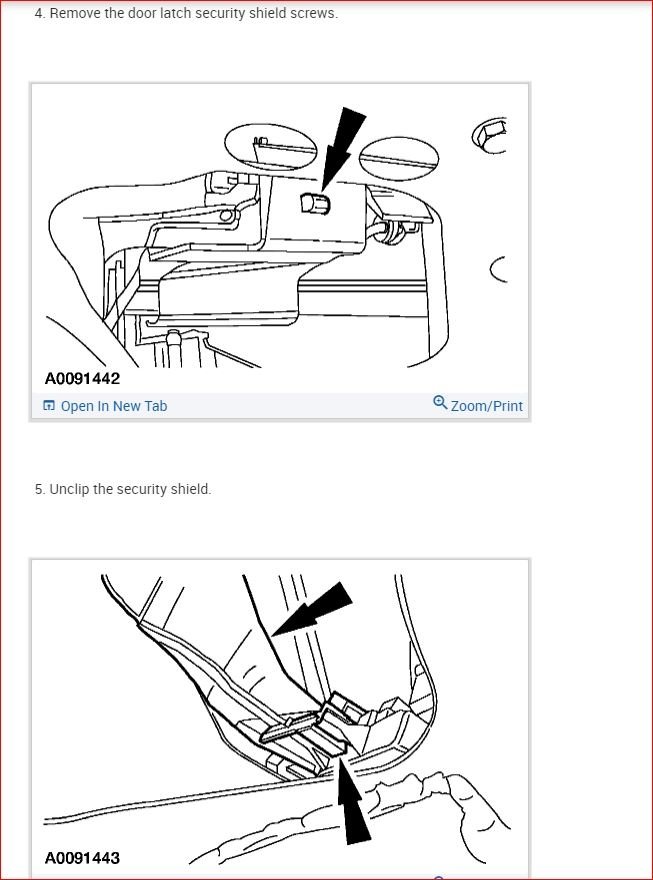

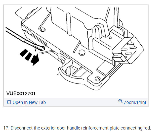

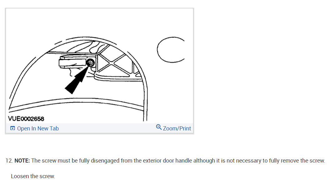

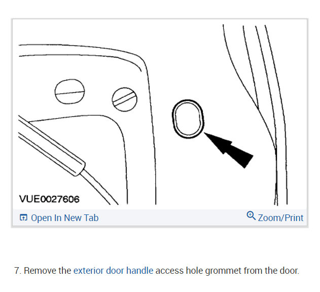

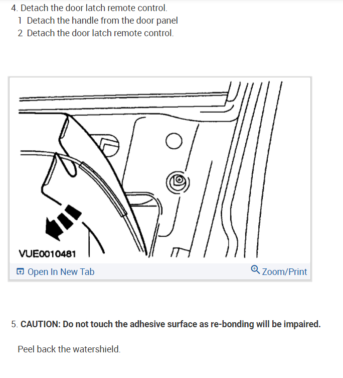

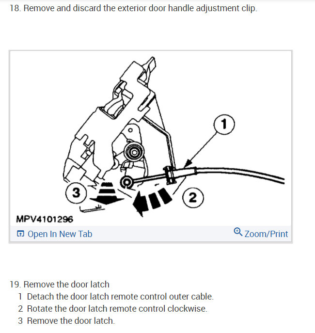

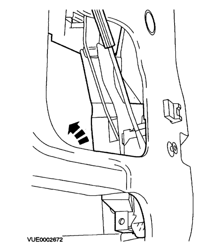

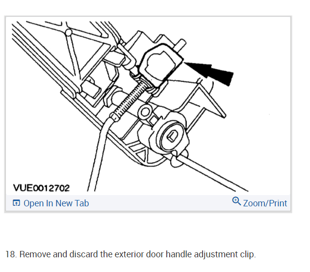

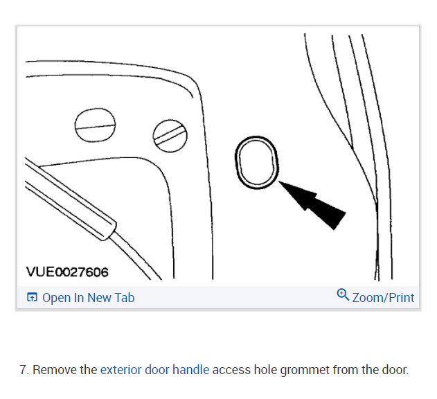

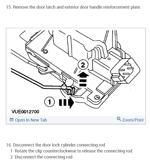

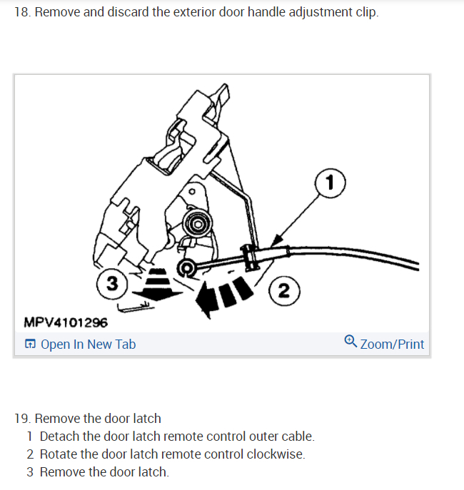

WRENCHTECH
  • 20,761 POSTS
This sounds like the door latch has failed and replacement is required I have included the door latch replacement instruction in the diagrams below. Check out the diagrams (Below). Please let us know what happens.
